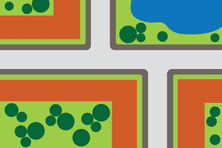

Polygon to grid raster
A Grid Overlay is a calculated overlay. It uses a 2-dimensional grid for calculation, data storage and visualization. The calculation divides the entire project into a grid of equally sized square cells, with possible size per cell ranging from 0.01m² up to 100m², depending on the size of the project area. This amounts to anywhere from thousands to millions of cells per overlay.
For each cell, a calculation is performed, the specifics of which depend on the overlay being calculated. This can be as simple as displaying (possibly inherently) rasterized data, such as GeoTIFF Overlays or the heightmap, or as complex as multi-step rainfall calculations.
