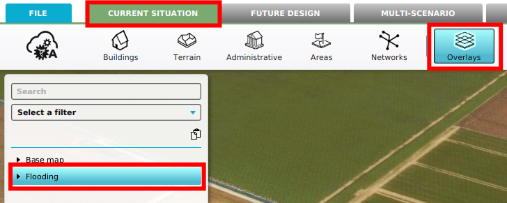

- Select Current Situation in the editor.
- Click on Overlays.

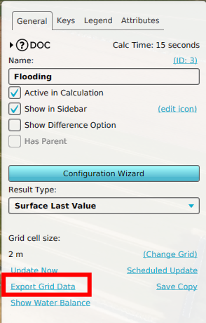

- Select the Grid Overlay that you want to export using the editor.
- On the Overlay's Detail Panel, select "Export Grid Data". This opens the Export Grid Overlay panel.

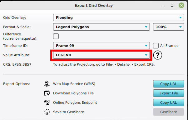

- Verify that the desired overlay is selected.
- Select one of the following formats: Legend Polygons, Legend MultiPolygons, Legend Points (center)

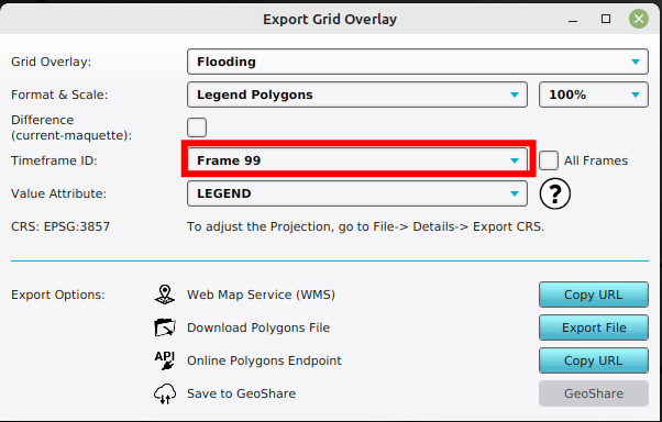

- If applicable, select a timeframe
- Optionally configure the Value Attribute of exported features to contain a different value than their Legend Entry Name.

Optionally select a particular timeframe and or difference overlay, if applicable.
Optionally configure the Value Attribute of exported features to contain a value different from their Legend Entry Name.
- Based on the legend colors of the Grid Overlay, a vectorisation of the raster data is created and can be exported as a GeoJSON. See also this page for more information on how to change the legend and this video tutorial (in Dutch):

- For grid overlays which produce multiple timeframes as results, it is possible to export a dataset at a certain timeframe, by selecting the index of the timeframe. It is also possible to export all timeframes at once by checking the All frames box.
