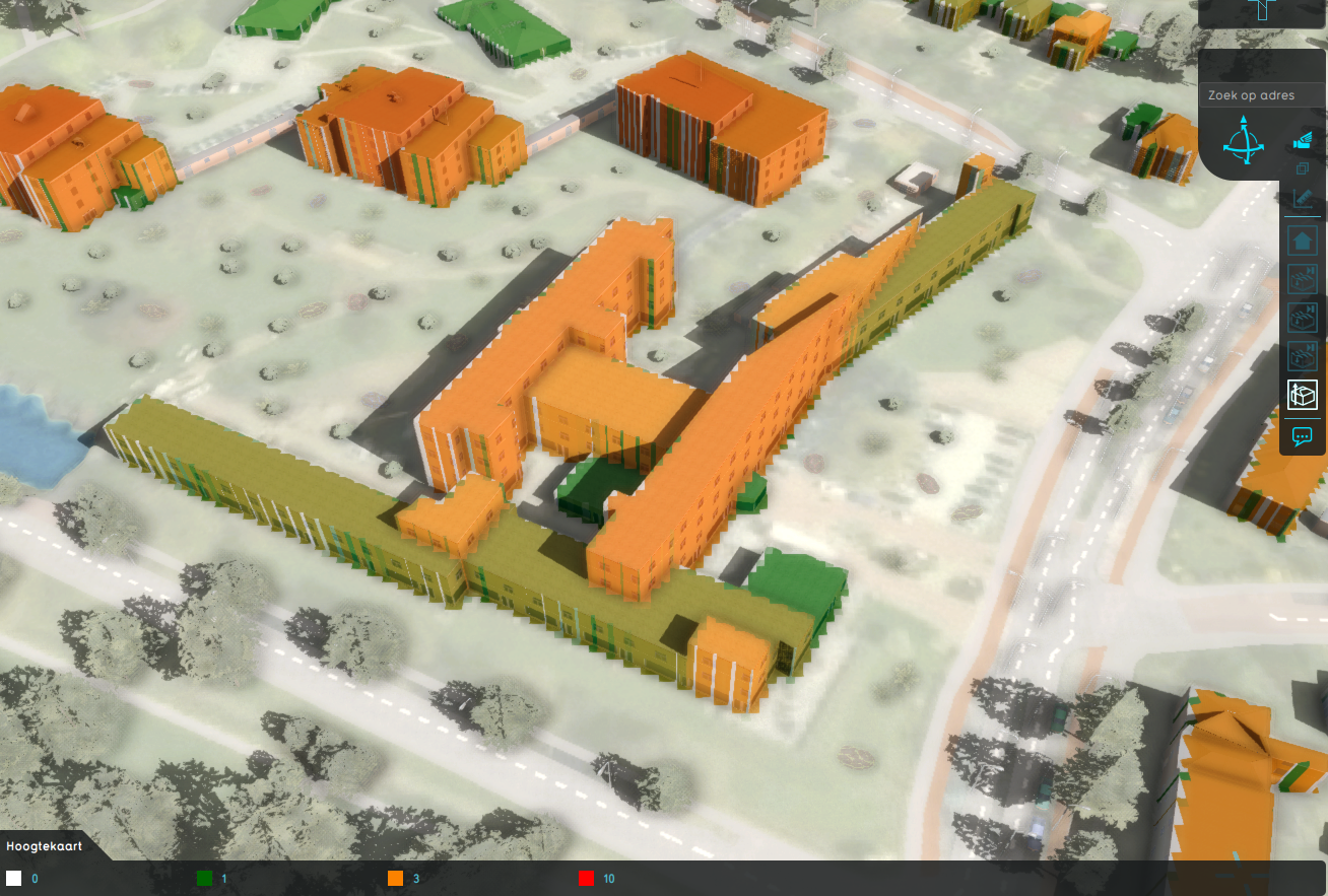

Example of the Building Floors Overlay
The Building Floors is one of three Heightmap Overlay model types that displays the amount of building floors at each grid cell.
It can be used to calculate floor space in a grid-based manner in a TQL query.
The three Heightmap Overlay model types are:
  • Digital Terrain Model Overlay: displays the height of the terrain at the selected location on the map.
  • Digital Surface Model Overlay: displays the height of the terrain and the height of the building that is located on the selected location on the map.
  • Building Floors Overlay displays the amount of floors of a Building at the selected location on the map.
