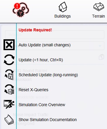

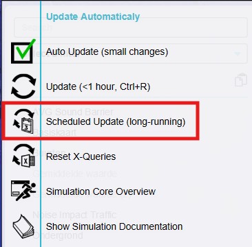

Auto Update (small changes)
The Auto Update (small changes) option is by default disabled. When active it ensures that whenever you make a change in the Editor or Scenario Test Run, the indicators, panels and overlays will be recalculated immediately, except for large changes which include X-queries and most model attribute's. For example switching Water Overlay from Rainfall to Groundwater requires a manual update.
When Auto-update is disabled, you will have to manually refresh the project after making any adjustment. You can refresh the project manually by choosing one of the available options; Scheduled Update (long running), Update or Reset X-Queries. Clicking on the Auto-update button itself triggers the Update Indicators option.
Compare the three different Project Update states below.

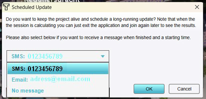

To ensure fair resource distribution, calculations are capped at 30 minutes; any exceeding this limit will timeout.
When a calculation is expected to take longer than 30 minutes, it is possible to schedule a long running calculation. This means the Tygron Platform allocates specific calculation resources without a time limit, which should not hinder other calculations taking shorter amounts of time.
When scheduling a long-running calculation, you can choose to be notified upon completion via email, SMS (registered or provided), or no alert. In addition, opting to schedule a long running calculations will automatically put the Project Session in Keep Alive mode. This means the Tygron Platform can be closed on the user's computer, and the Session will remain active, allowing a user to reconnect to the Session within a week.
Like with shorter calculations, if all calculation resources which allow long running calculations are already in use, the calculation remains queued until resources free up.

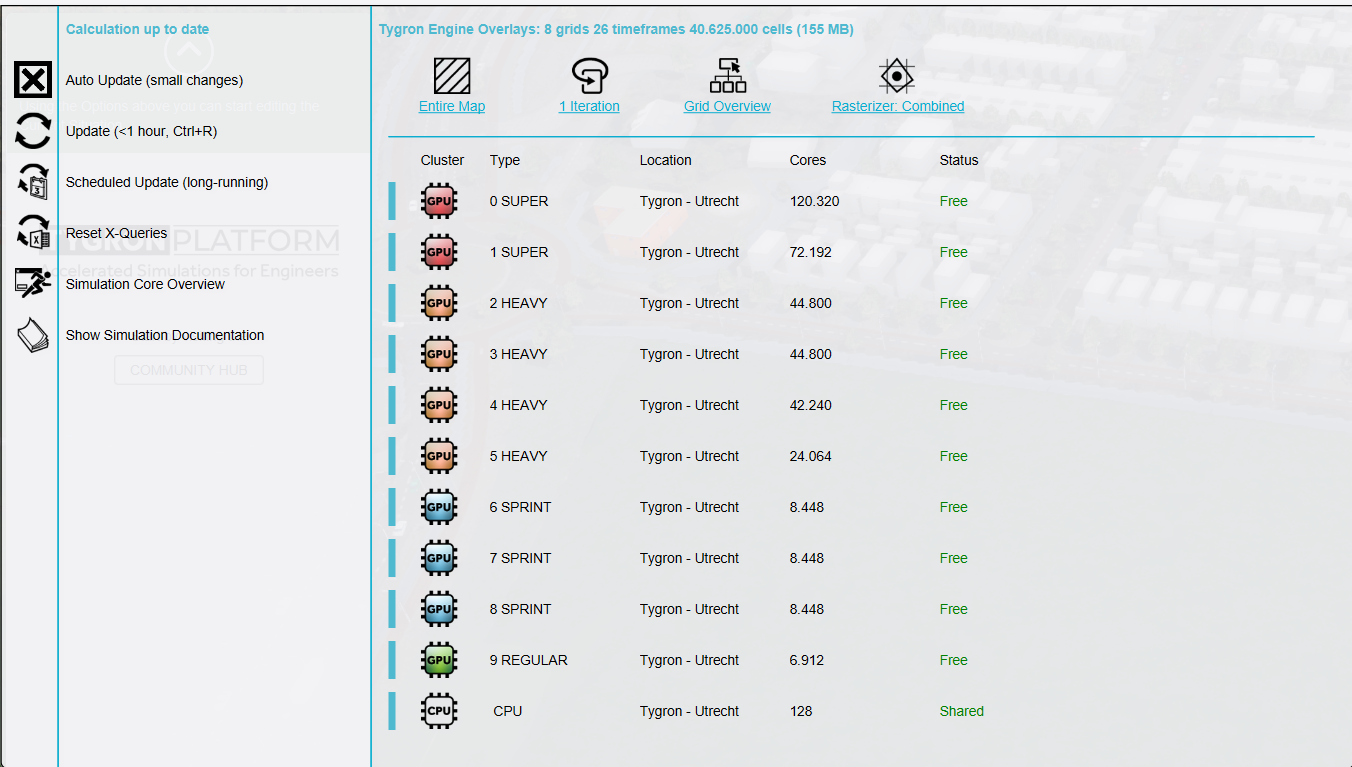

GPU overview
The GPU cluster overview shows the different GPU clusters that are available for calculation and their status. If they are busy with calculating components of other projects of other users, it will be visible here. Your active calculation jobs are also listed, where you can cancel them using the cancel icon. The GPU clusters where short is stated are used for short calculations (max 30 minutes). The other GPU clusters are available for Long running scheduled calculations.
