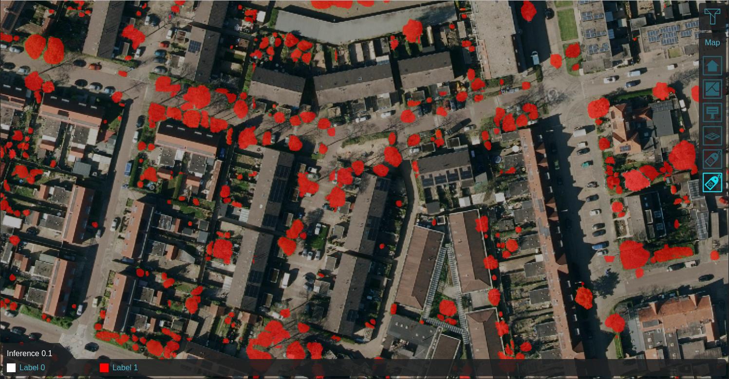

Labeled features on 0.25m satellite image

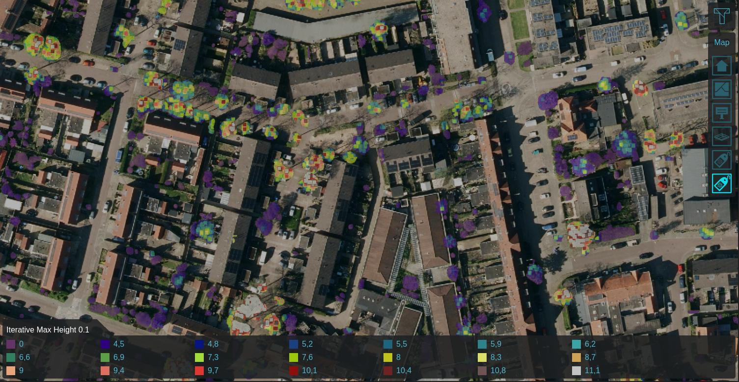

Max neighboring height within 0.25m, iterated 5 times
