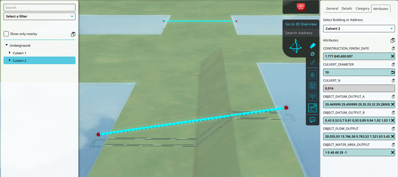

Culvert with end-points at different heights (29 m and -1 m), also indicated by OBJECT_WATER_AREA_OUTPUT.
  • By default, since the default value is the minimal surface value, each end-point of a culvert is put on the bottom of the waterway at that end-point, determined by terrain height.
  • The height at which the end-point of a culvert is situated is stored as the 5th and 6th value of the OBJECT_WATER_AREA_OUTPUT array.
  • The Culvert threshold supports only one value, not one for each end-point.
