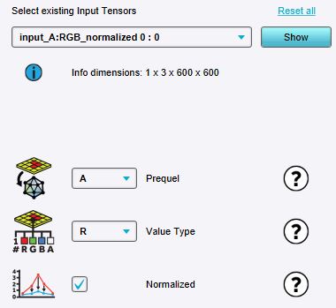

An input tensor link in the Inference Overlay Wizard.
A tensor link references:
  • The input tensor, identified by the n (images) and c (channel) tuple, which are mentioned in the name of the tensor link, as well as the width and height of the input tensor.
  • The prequel of an Inference Overlay that should be used to obtain values from
  • The value type of the data of the prequel;
    • When it is a color, you can specify which color channel should be used; Red, Green, Blue or Alpha
    • When it is a floating point value, simple specify DEFAULT.
  • Whether the value should be normalized; Color channels are always normalized between 0 and 255. Floating point values are normalized using the calculated min- and max-value of the specified input prequel overlay.
