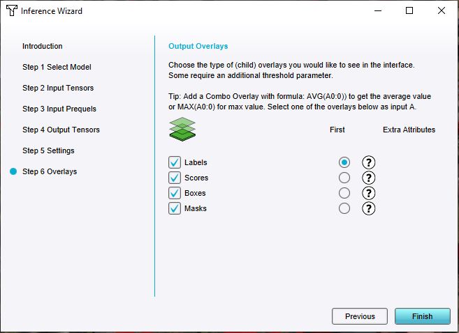

- In the Overlays step, select all result overlay types and click finish.

Add all result overlays.
