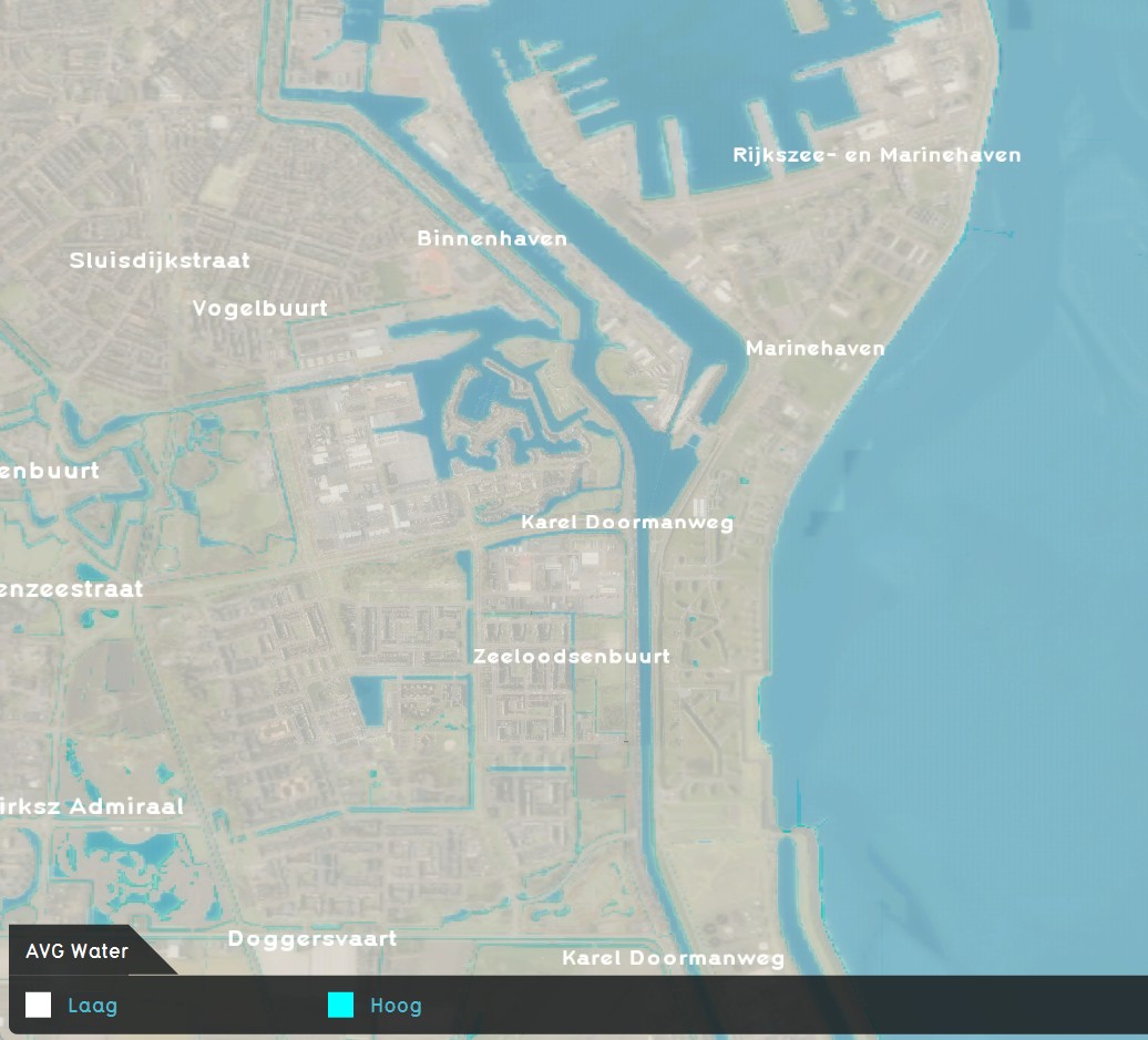

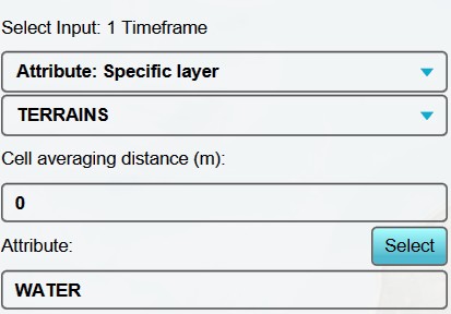

  1. Add an Average Overlay, we will use this to assign water areas.
  2. With this overlay selected, set the input options to "Attribute: Specific Layer" and "Terrains".
  3. Because we want a sharp distinction between water and land, we set the cell averaging distance to 0 meters.
  4. As attribute to look for, we select "WATER".
  5. Select finally "Update Now", and you have created an overlay that displays all open water areas.

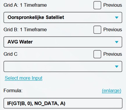

  6. Now add a Combo Overlay.
  7. Select the Original Satellite overlay as input for Grid A.
  8. Select the Avg Water Terrains overlay as input for Grid B.
  9. Enter the following formula: "IF(GT(B, 0), NO_DATA, A)". This formula checks whether a point is in a water area. If so, it returns no data, else it returns the satellite image.
  10. Select again "Update Now".

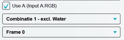

  11. Now use this new combo overlay with a filtered satellite image as input for your inference overlay, and update. You have now excluded open water areas from your inference overlay.

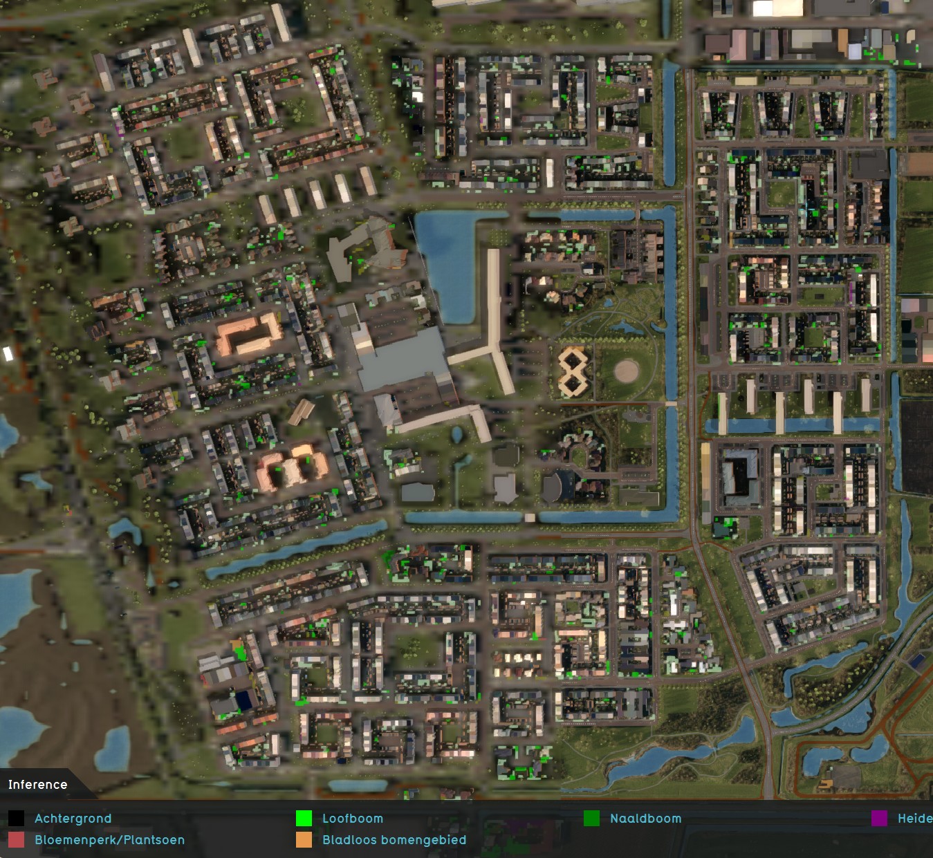

Only include private yards, and exclude the rest from an Inference Overlay
To improve a heat stress calculation, inference can be used to gain data of foliage in private gardens. For this you can mask all data except private yards from the satellite image.

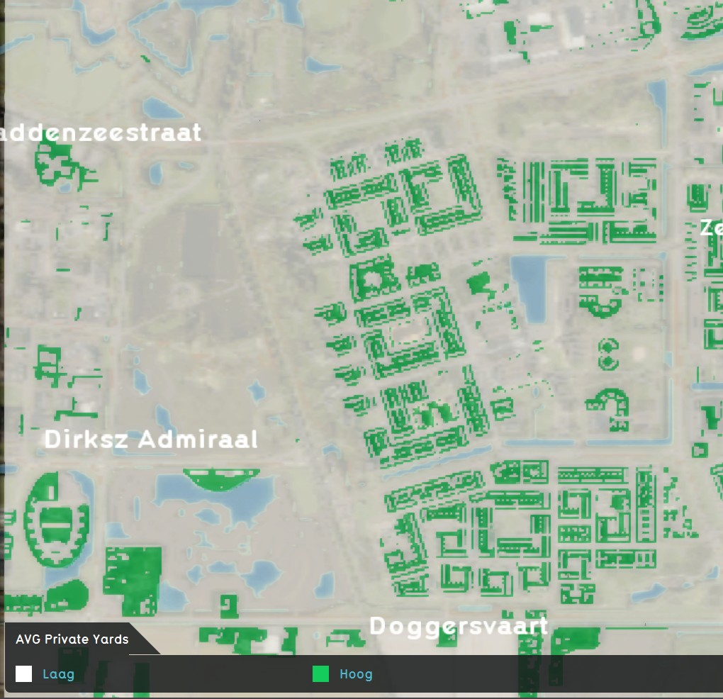

  1. Add an Average Overlay, we will use this to assign private yards.
  2. With this overlay selected, set the input options to "Attribute: Specific Layer" and "Buildings".
  3. Because we want a margin all around to look for foliage at the edges of the private Yards, we set the cell averaging distance to 3,5 meters.
  4. As attribute to look for, we select "PRIVATE_YARD".
  5. Select finally "Update Now", and you have created an overlay that displays all private yard areas/ gardens.

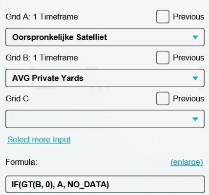

  8. Select the Avg Private Yards overlay as input for Grid B.
  9. Enter the following formula: "IF(GT(B, 0), A, NO_DATA)". This formula checks whether a point is in a private yard. If so, it returns the satellite image, else it returns no data.
  11. Now use this new combo overlay with a filtered satellite image as input for your inference overlay, and update. You have now excluded everything but private yards from your inference overlay.

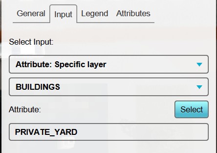

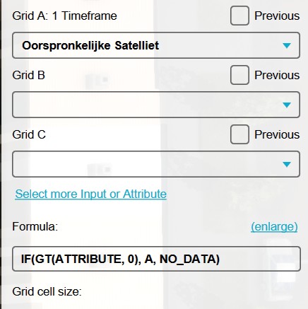

  1. Add a Combo Overlay.
  2. Select the Original Satellite overlay as input for Grid A.

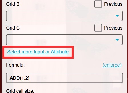

  3. Click on 'Select more Input or Attribute'.
  4. Ensure that for input 'Attribute: Specific Layer' and 'Buildings' is selected.
  5. Select or enter 'PRIVATE_YARD' as attribute.
  6. Enter the following formula: "IF(GT(ATTRIBUTE, 0), A, NO_DATA)". This formula checks whether a point has a value for the attribute PRIVATE_YARD. If so, it returns the satellite image, else it returns no data.
  7. Select again "Update Now".
  8. Now use this new combo overlay with a filtered satellite image as input for your inference overlay, and update. You have now excluded everything but private yards from your inference overlay, based on the attribute PRIVATE_YARD.
  • The detected foliage overlay can be used to import as trees or foliage areas into your project.
