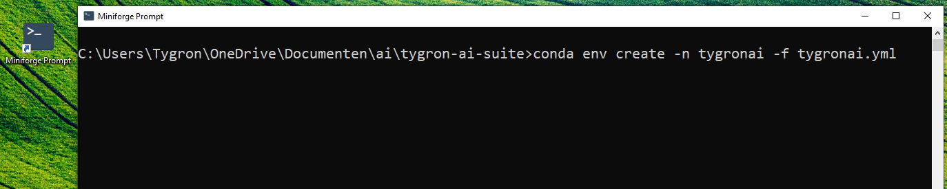

- Open the Miniforge Prompt application.
- Change the directory to the path of the local repository. For example
cd user/git/tygronai/
This directory should contain the tygronai.yml file. - Create and initialize a new Conda environment with the tygronai.yml file using:
conda env create -n tygronai -f tygronai.yml
and press enter to confirm. - Wait for the downloads and unpacking to complete.

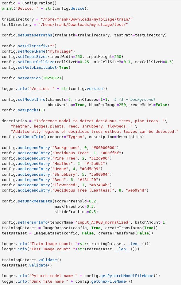

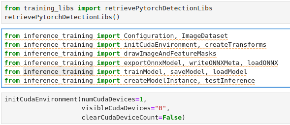

- Once in the correct folder, select the "example_config.ipynb".
- Adjust the following parameters:
trainDirectory = "PATH TO TRAIN FILES"
testDirectory = "PATH TO TEST FILES"

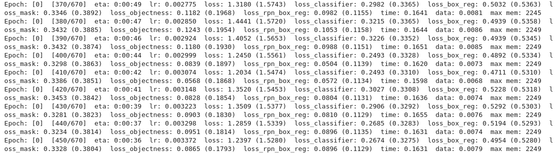

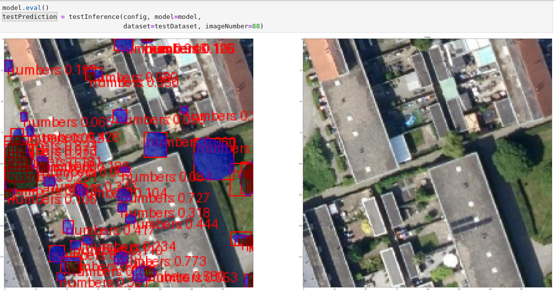

to the folders containing the exported datasets. See how to export AI datasets for more information. - Press the double arrow button named Restart kernel and execute all cells to run the Jupyter Notebook. See the images below of what to expect.
- Eventually an ONNX file will be created.

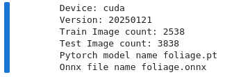

- In the step with the Configuration of the example_config notebook, cuda should be printed. If not, cpu will be printed. Training a model on your cpu is significantly slower. You might need to open the command line tool on your computer and run the command nvidia-smi to find out what version of cuda is supported on your gpu.
- To train a better model, increase the number of trained epochs, for example to 20:
config.setEpochs(20)
On the other side, training with too many epochs may not improve the model; it will become too strict.
