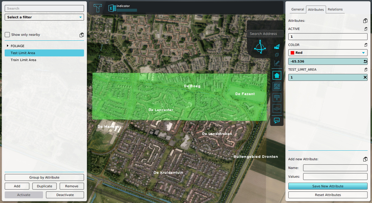

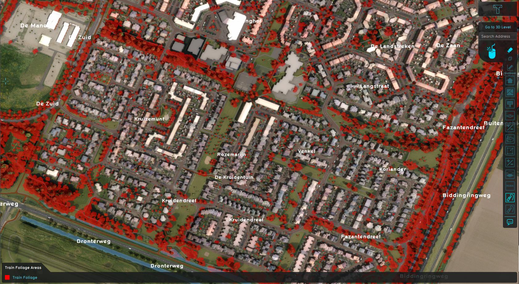

Demo Train Dataset is a project that contains shapes of foliage, drawn as areas on top of a Satellite Overlay. These areas, in combination with satellite images, can be exported as a dataset for training a Mask R-CNN model. Such a model can then be applied to a different project location to detect foliage. A specific use-case is detecting foliage on private property, such as gardens and private yards. Each area is assigned the attribute FOLIAGE. The project also contains two large areas, named Test Limit Area and Train Limit Area, each with a unique TEST_LIMIT_AREA or TRAIN_LIMIT_AREA Attribute. These areas will be used to split the Foliage areas into a group of test and train data.
Individual foliage areas

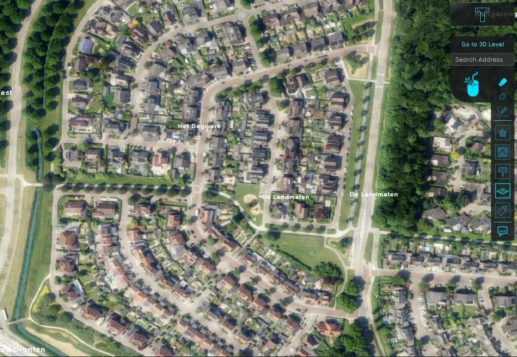

Satellite Overlay serving as input for images

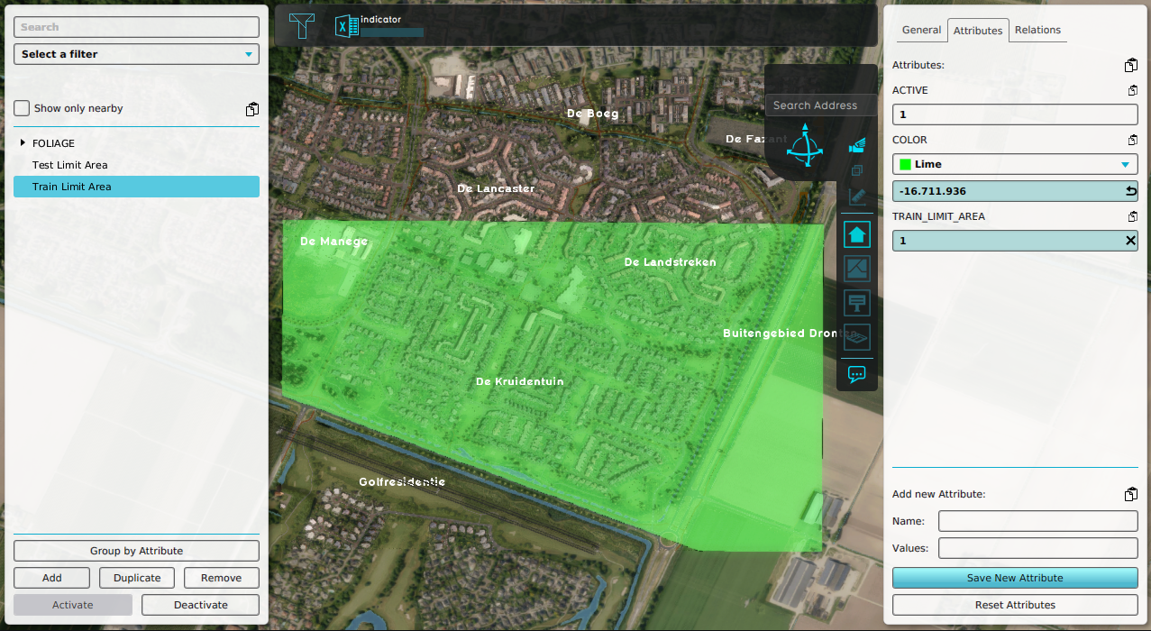

Train limit area used for exporting a Train Dataset.
Test limit area used for exporting a Test Dataset.

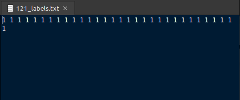

- A label text file containing the classes of the identifiable features, where each class is identified with an integer number (larger than 0).

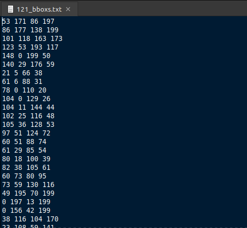

- Optional: A text file containing the bounding-box pixel numbers; min x, min y, max x, max y, for each identifiable feature in the input image.
Input image, in this case an image exported using the Satellite Overlay

Class labels
Bounding box coordinates

- One large area with the attribute TRAIN_LIMIT_AREA
- One large area with the attribute TEST_LIMIT_AREA.
The limit areas can be used to export a subset of the FOLIAGE area. Each subset can be exported with an Overlay. Since both sets are drawn based on a Satellite Overlay named Original Satellite, we will use that Overlay.

- Select the Intersecting Areas option, and select the following attribute TRAIN_LIMIT_AREA

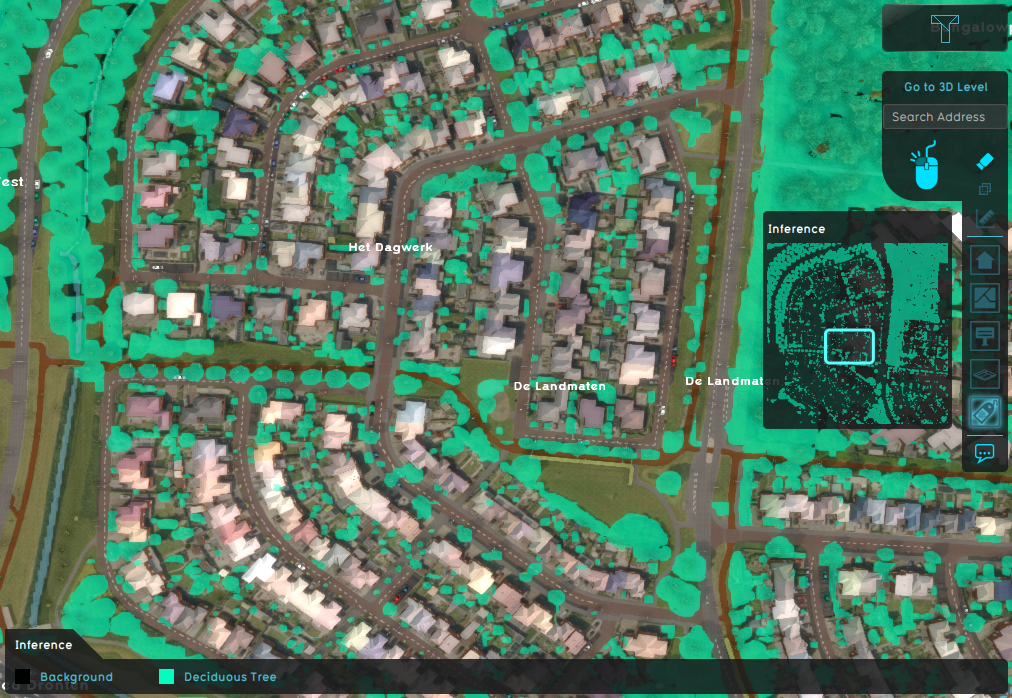

Once you have trained your own AI model and exported it to ONNX, you can import this model into your project and apply it using an Inference Overlay.
First, create a new project in a different geographical location than this demo. Please follow the steps of the New Project Wizard.
Once you have created a new (non-empty) project opened in the editor, you can continue with the configuration of an Inference Overlay.

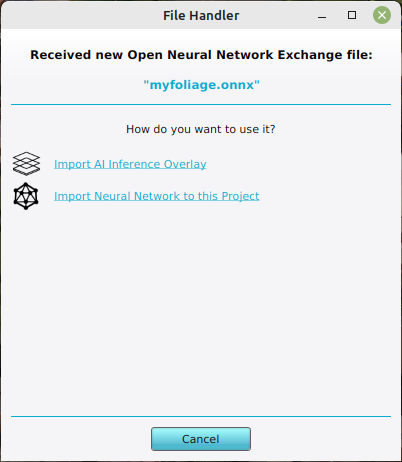

- To do so, drag the ONNX file onto the Tygron Client Application
- With the popup menu shown, select the option: Import as an Inference Overlay. This Inference Overlay should be configured almost automatically.
- Next, add a new Satellite Overlay.
- Next, select the Inference Overlay and for Input A, select the Satellite Overlay
ONNX file popup in the Tygron Client
Input Satellite Overlay
Inference Overlay using the imported ONNX file

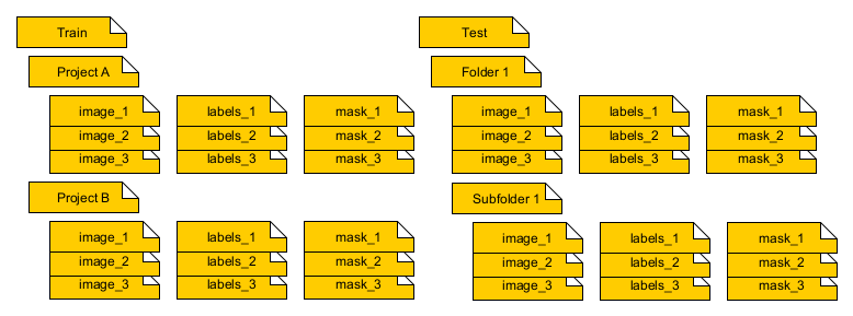

- The train sets can obtain data files from sub-folders. For example, if data was exported to user/documents/foliage/train/demo_training_data, the PATH_TO_TRAINING_DATA can be user/documents/foliage/train/. This makes it easier to train on data exported from multiple projects and combining it with your own custom data.
