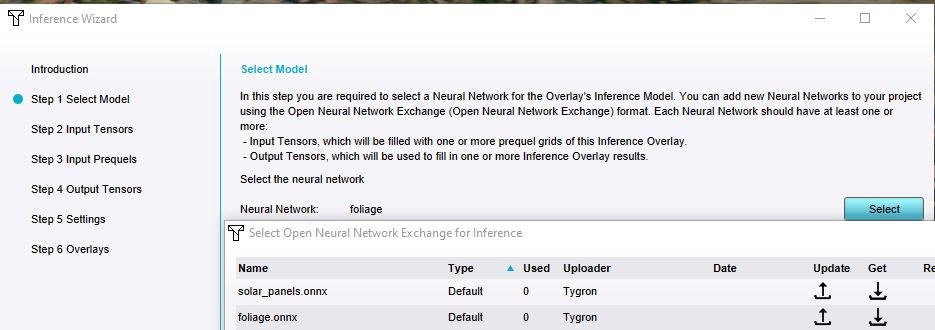

Selecting a Neural Network in the Inference Overlay Wizard
A Neural Network in the AI Inference Overlay is a pre-trained Region-based Convolutional Neural Network (RCNN) [1] that can be used to classify or detect features given one or more input Overlays. Neural Networks are stored in the Tygron Platform as data items with a reference to an ONNX-file (Open Neural Network Exchange format[2]) visible via Netron[3].
Input and output for neural networks are handled using data tensors. These tensors are multi-dimensional data arrays. They are automatically identified when selecting or adding a new Neural Network.
Whether a Neural Network classifies or detects objects given an input depends on its inference model. Such a model is created using AI software, such as PyTorch. Neural Networks can indicate what type of network they are by defining the INFERENCE_MODE attribute in their metadata.
