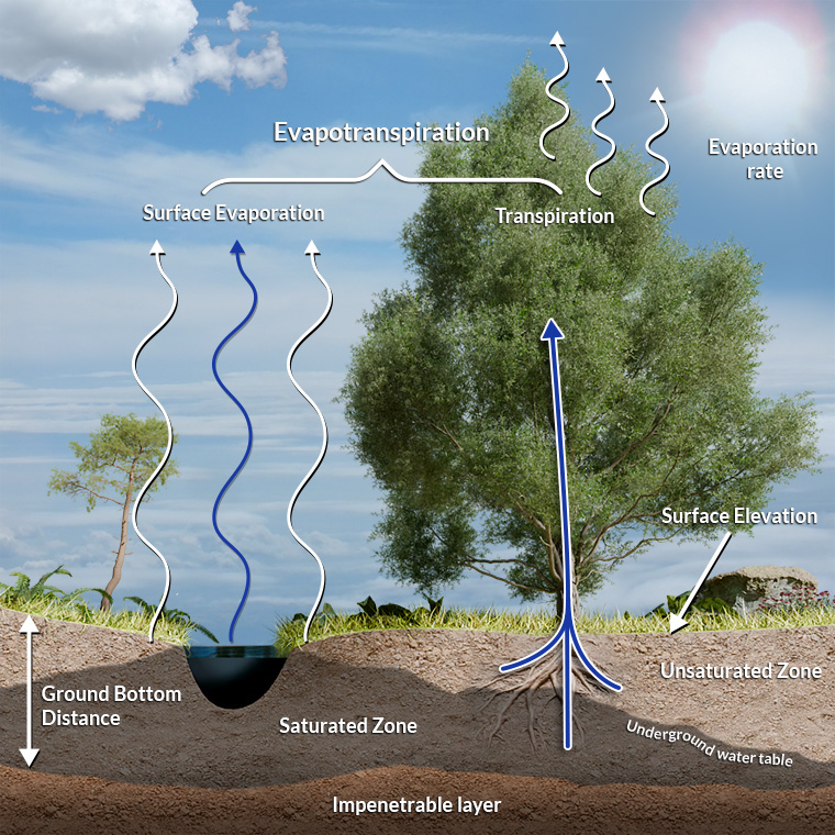

Evapotranspiration is the combined process of water transferring to the atmosphere from open water and vegetation. Two types are implemented:
  • Evaporation: the movement of water directly to the air from sources such as the soil and water bodies. It can be affected by factors including heat, humidity, solar radiation and wind speed.
  • Transpiration: the movement of water from root systems, through a plant, and exit into the air as water vapor.
Both forms can be configured directly by setting the weather's evaporation rate. The weather's evaporation rate is defined as a period during which a certain rate of evaporation will take place, similar to rainfall. Multiple evaporation periods can be defined. The general evaporation amount per period is converted to an amount per second.
If a grid cell contains less water than the maximum potential evaporation for a timestep, only available water evaporates; the remainder is discarded.
The default setup for evaporation consists of a single period of evaporation and an evaporation amount. It is possible to configure an evaporation rate which varies over time. More periods with varying amounts of evaporation (including an evaporation rate of zero) can be defined.
Surface Evaporation
Water situated on the surface is conceptually able to evaporate. The amount is based on the weather's evaporation rate and the overlay's SURFACE_WATER_EVAPORATION_FACTOR. The product of these two attributes results in the actual rate of evaporation. The water in each individual cell at the surface is then subject to the calculated rate of evaporation, according to the surface evaporation formula.
Ground Transpiration
Water can transpire from the ground if the cell's surface meets either of the following criteria:
In other words: if a building is present the building's properties are used, otherwise the terrain's properties are used.
Feddes factor
Conceptually, water can transpire from the ground via crop, tree and plant foliage. Their roots can draw water from the unsaturated and saturated zones in the ground, when these reach deep enough and the transpiration factor is non-zero. Water is drawn from the ground and transpired into the air, effectively removing it from the hydrological model. Water for transpiration can only be drawn from sections of the ground which are within reach of the roots, as defined by the root depth. Using the multiple root depth values, it is also possible to define a threshold at which the roots are unable, or less able, to extract ground water, due to oxygen stress. In such cases, up to four root depth values must be provided, ordered from deepest to shallowest.
Seasonal factor
Varying evaporation factor of grass, depending on the time of year.
The ground evaporation can be configured directly by changing the terrain type's WATER_TRANSPIRATION_FACTOR and building's WATER_TRANSPIRATION_FACTOR. If these attributes are set to 0, no ground evaporation will take place. This attribute can also be set as 4 distinct values, one for each growth season. This allows for more transpiration during a crops growth season and less during the winter.
Varying transpiration rate
Similar to the surface evaporation, the rate of ground transpiration is also determined by the weather definition's evaporation rate. Multiplying the weather's evaporation rate and the transpiration factor of the building or terrain (as applicable) gives the actual transpiration rate for the ground.
Ground transpiration first draws water from the unsaturated region and then from the saturated region. If, according to the calculated transpiration rate, a sufficient amount of water can transpirate from the unsaturated zone, no water will transpirate from the saturated zone. Otherwise, available water in the unsaturated zone is transpired first, with any remaining requirement drawn from the saturated zone. The sum of transpiration in the unsaturated zone and the saturated zone will never exceed the calculated transpiration rate.
