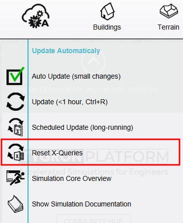

Auto Update (small changes)
The Auto Update (small changes) option is by default disabled. When active it ensures that whenever you make a change in the Editor or Scenario Test Run, the indicators, panels and overlays will be recalculated immediately, except for large changes which include X-queries and most model attribute's. For example switching Water Overlay from Rainfall to Groundwater requires a manual update.
When Auto-update is disabled, you will have to manually refresh the project after making any adjustment. You can refresh the project manually by choosing one of the available options; Scheduled Update (long running), Update or Reset X-Queries. Clicking on the Auto-update button itself triggers the Update Indicators option.

Reset X-Queries
Main article: X query (Excel)#Resetting X queries
Often, Excels for Indicators or Panels use X-Queries. These queries are interpreted by the Tygron Platform as "for every" of a certain Item. For example, {code|SELECT_NAME_WHERE_AREA_IS_X} will resolve to multiple queries, one for every Area. These individual queries are then reused whenever a calculation is performed.
When new Items matching the X-Query are added, or such Items are removed, it is necessary to use the "Reset X-Queries" option, to force the Tygron Platform to re-evaluate for which Items individual queries should be generated. Failure to reset queries may exclude new items from calculations or cause errors by referencing deleted items.
When to choose which option?
Choose Reset X-Queries if the amount of areas or neighborhoods is changed (for example by adding or removing an area/neighborhood). Choose Update Indicators if the amount of areas or neighborhoods stays the same (for example if you only changed an attribute of an area or if you did not use X-Queries in your Excelsheet.
Using any one of these option affects all Indicators, Panels and Grid Overlays.
