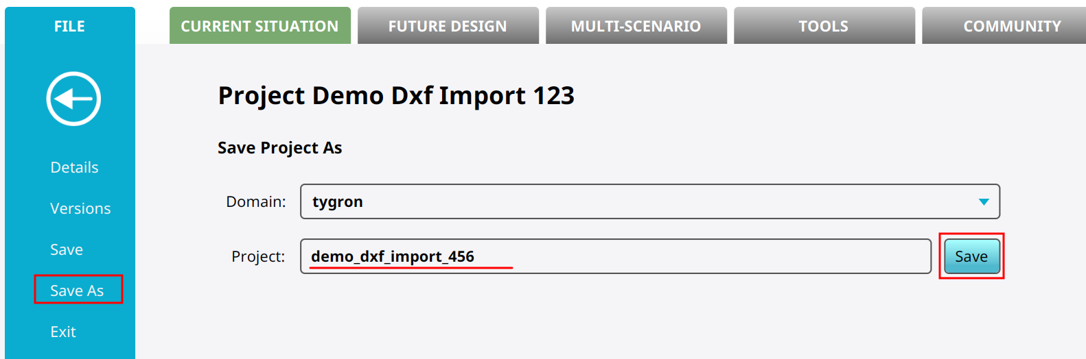

Save As
Pressing "Save As" facilitates users in saving the project with a new name.
The same restrictions apply when creating a new project, between 3-20 characters.
Saving the current project to a new project with the provided name
