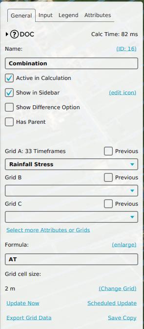

- Hover over Overlays in the ribbon bar.
- Hover over Grid Calculation under Add New, and select Combo.
- For Grid A, select a Grid Overlay
- For Formula, write AT if you want to collect all timeframes, A if you only want to collect the last timeframe.
- Click on the update link to initialize the Combo Overlay

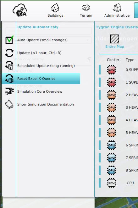

- Hover over the Calculation Cloud in the ribbon bar.
- Select the option Reset X-Queries.
- The Combo Overlay is now setup to accumulate overlay results.

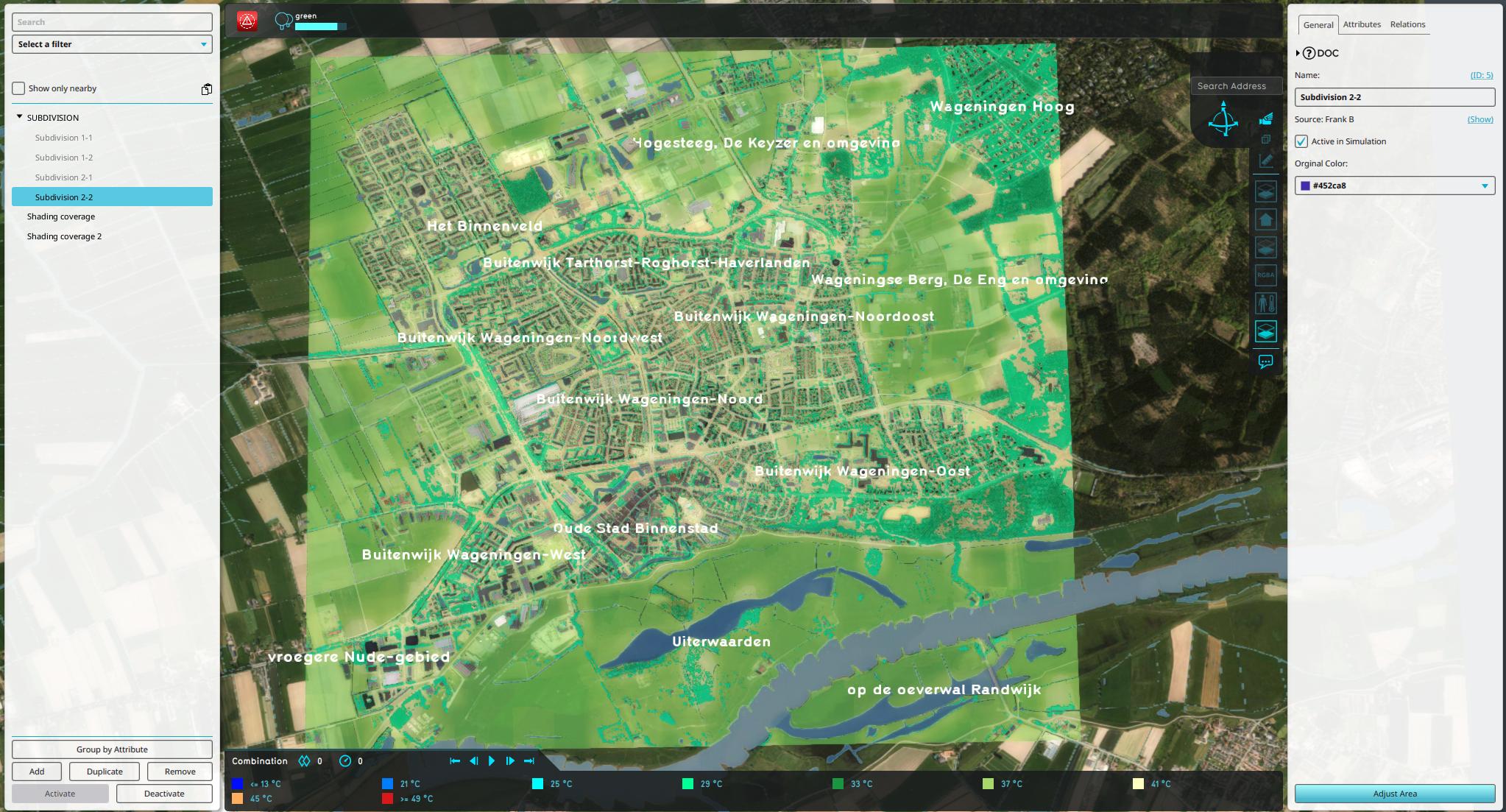

- Deactivate all Subdivision areas.
- Activate one specific Subdivision Area.

Setting the Input Attribute for the Combo Overlay to the Area Attribute SUBDIVISION.

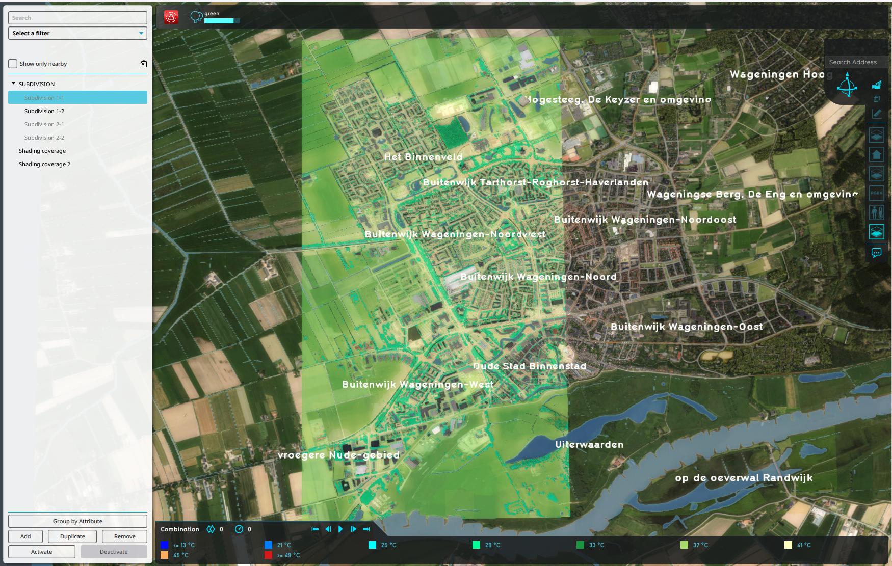

Activating one Subdivision Area at a time.

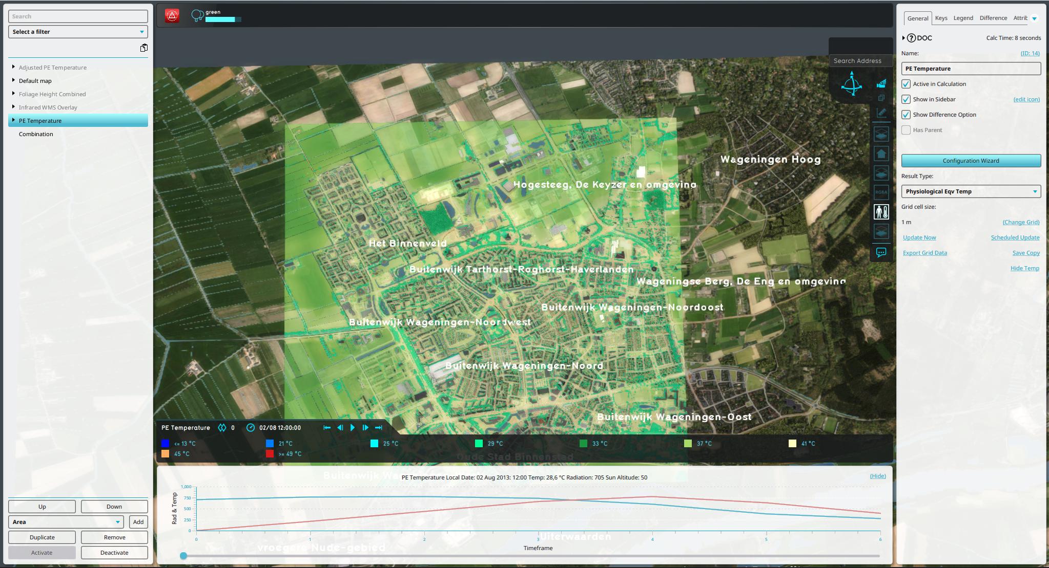

The Heat Stress Overlay calculated for the subdivision with margin.
The result of the first calculation stored in the Combo Overlay, which is without the margin.
The combined result of the first and second calculation stored in the Combo Overlay.
The four parts calculated and stored in the Combo Overlay.
