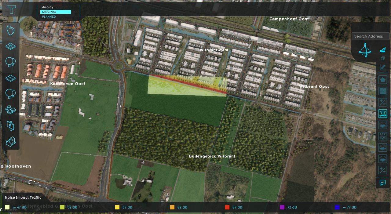

Limit Map is a Setting that stores the Multi Polygon that will be used to limit the calculation of active Grid Overlays.
When this setting is configured with a non-empty Multi Polygon, the grid and TQL Queries are limited to a portion of the map. Limit map is always a rectangle bounding box of the Multi Polygon of the setting.
Calculation limited by a Areas, enveloped by a rectangular bounding box
