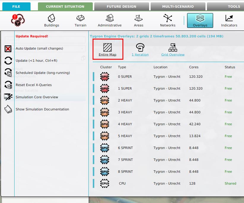

How to calculate only a part of the Project map:
  1. Hover over the Calculation Cloud in the ribbon bar
  2. And click on the Entire Map link.
  3. In the Area Selection Panel, select an Area that the calculation should be limited to.
  4. Confirm the selection
  5. Click on the Calculation Cloud icon to recalculate.
  6. Once the calculation has completed, select Overlays in the ribbon bar.
  7. Select any active Grid Overlay that was just calculated.
  8. Zoom out by clicking on the Entire Map button in the Navigation Panel
  9. Notice only a subsection of the project area is calculated.
