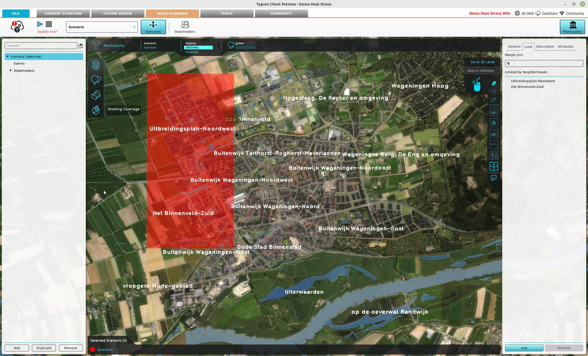

Scenario Overlay with a Neighborhood Measure scope limited by neighborhoods and a margin of 500 meters.

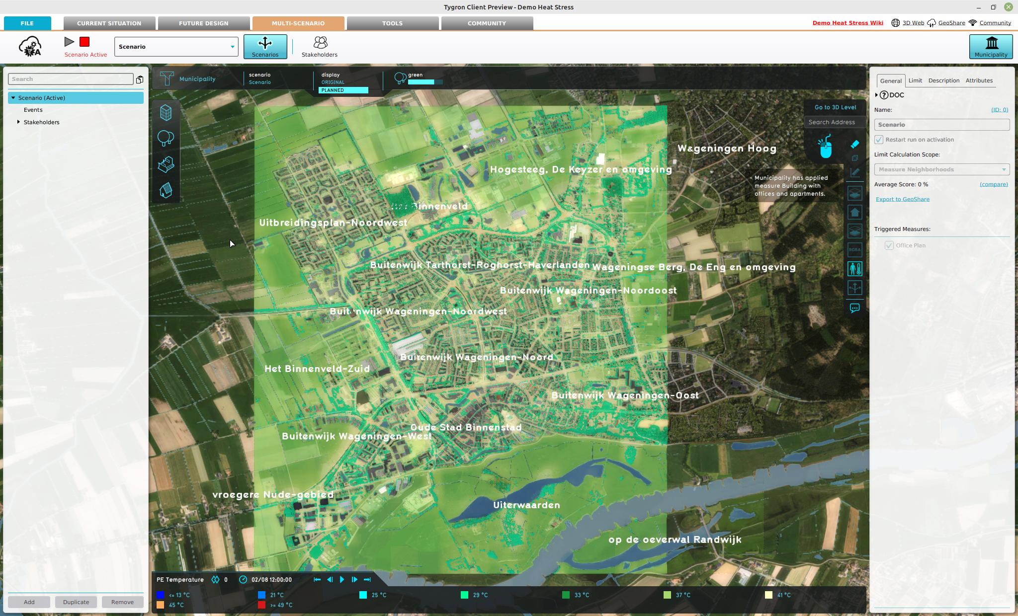

Heatstress Overlay with a Neighborhood Measure scope limited by neighborhoods and a margin of 500 meters.

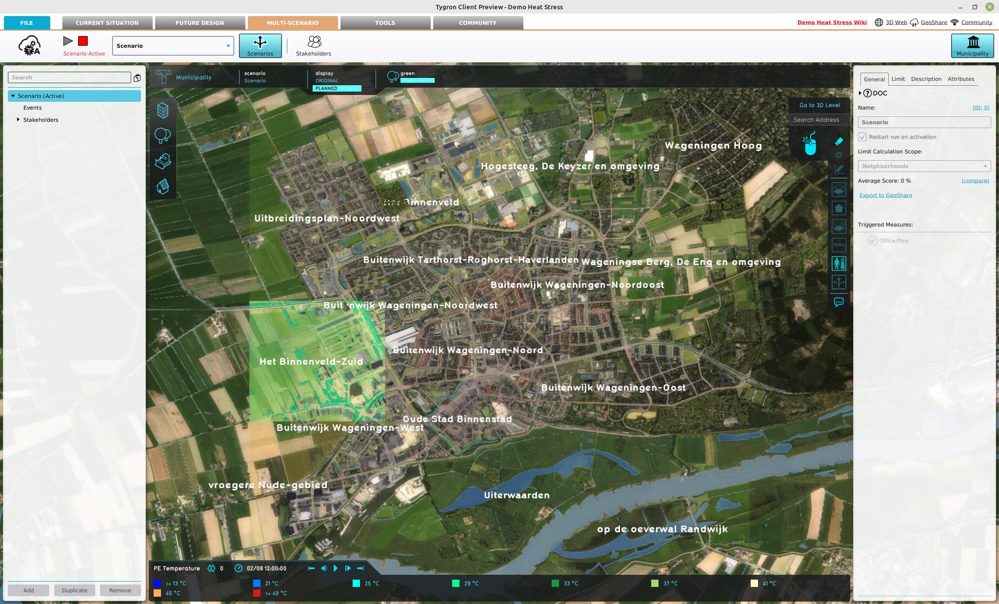

Scenario Overlay with a Neighborhood Measure scope limited by neighborhoods and a margin of 0 meter.
Heatstress Overlay with a Neighborhood Measure scope limited by neighborhoods and a margin of 0 meter.

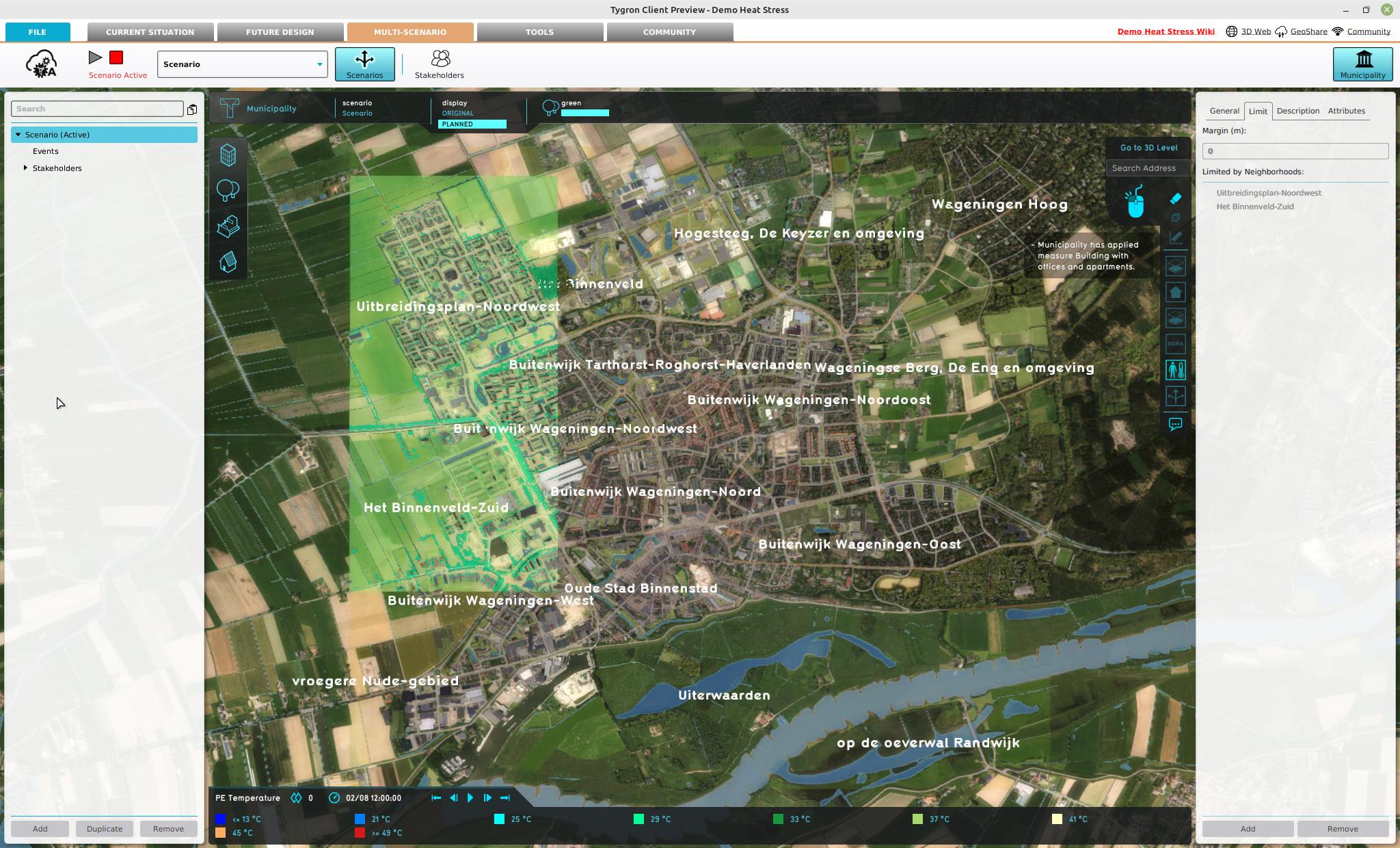

Heatstress Overlay with a Neighborhood scope limited by one selected neighborhood.
