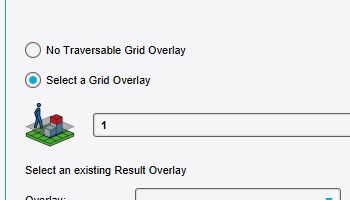

A Travel Distance Overlay requires two spatial inputs: destinations and traversables.
Projects created with real world data virtually always include some form of road network, which a Travel Distance Overlay will use by default as its traversable input. Destinations must always be explicitly provided, either by manually drawing in relevant locations, importing them from an external source or file, or by calculating them on-the-fly.
Next, the most important setting for a Travel Distance Overlay is the maximum allowed travel distance, which is a simple numerical setting.

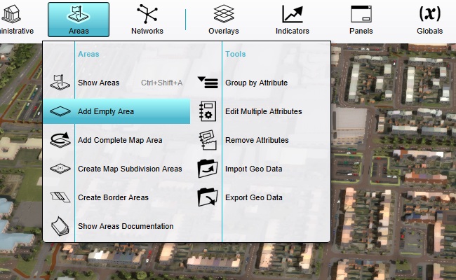

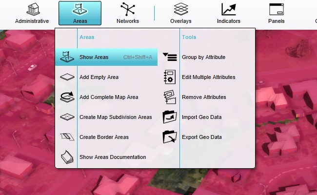

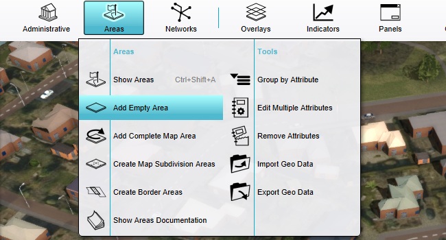

Add a new Area to the Project.
Editor → Current Situation (Ribbon tab) → Areas (Ribbon bar) → Add Empty Area (Dropdown)
Adding a new Area to the Project.

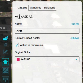

A new Area is now added, and selected in the left panel.
The Area is listed.
Its details are displayed in the right panel.
The right panel with details on the new Area.

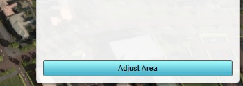

At the bottom of the right panel, click on "Adjust Area" to start manually drawing it in the Project map.
The option to start drawing the Area.

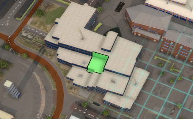

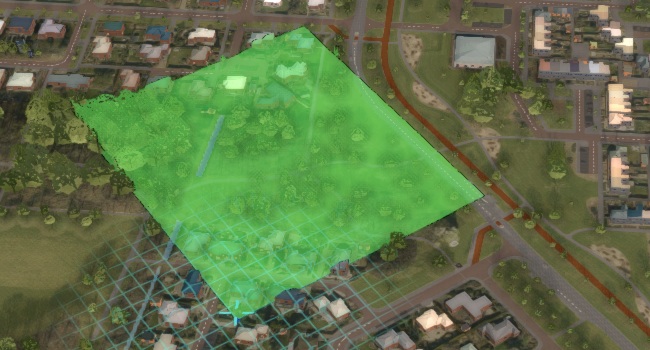

Draw it in the location of a park or similar recreation area. Ensure that it is somewhat oversized, overlapping with the road network.
A drawn selection of a large point of interest.

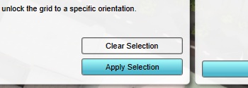

When drawn in properly, click on "Apply Selection".
The option to confirm the drawn selection for the Area.

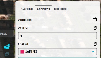

In the right panel, switch to the Attributes tab.
The Attributes tab.

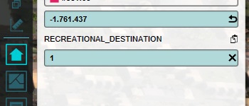

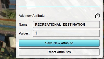

At the bottom of the right panel's list of Attributes, fill in the form for a new Attribute with the following input:
  • Name: RECREATIONAL_DESTINATION
  • Values: 1
Information for a new Attribute.

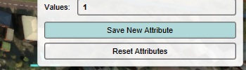

Click on "Save New Attribute" to add the Attribute to the Area.
Save the new Attribute.
The new Attribute now appears in the Area's list of Attributes.
The new Attribute is now listed.

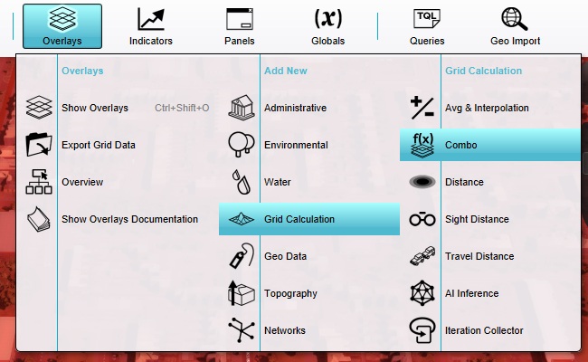

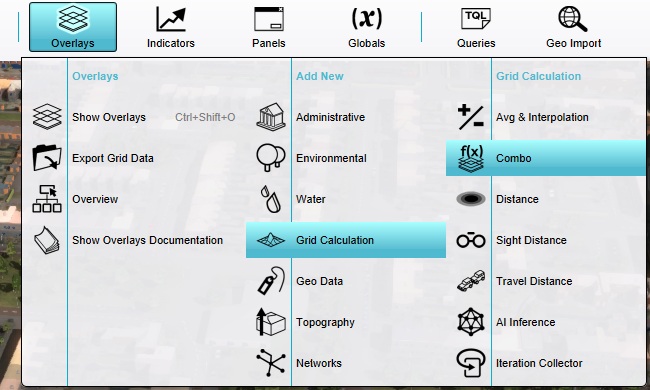

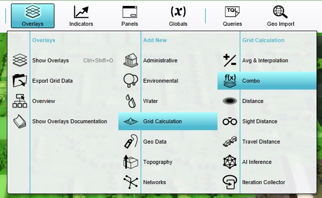

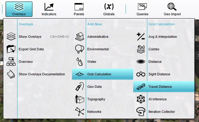

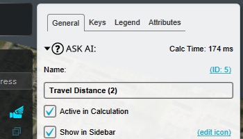

Add a Travel Distance Overlay.
Editor → Current Situation (Ribbon tab) → Overlays (Ribbon bar) → Grid Calculation (Dropdown) → Travel Distance
Adding a Travel Distance Overlay.

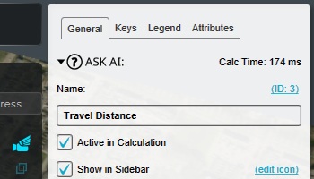

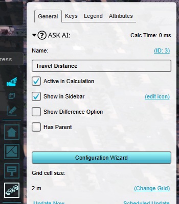

A Travel Distance Overlay is now added, and selected in the left panel.
The selected Travel Distance Overlay.

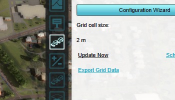

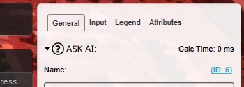

With the Overlay selected in the left panel, its details are displayed in the right panel.
The details shown in the right panel.

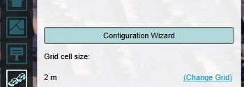

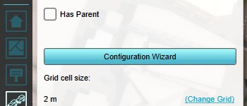

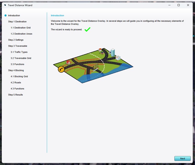

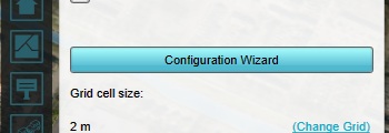

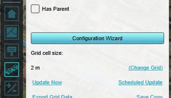

Click on "Configuration Wizard".
The button to open the configuration wizard.
This opens the Configuration Wizard which will assist in setting up the Travel Distance calculation.
The configuration wizard opened.

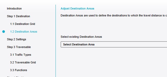

Continue to the step regarding Destination Areas (skipping over any intermediate steps if necessary).
The step for defining Destination Areas.

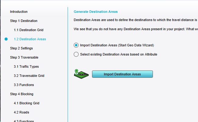

This step allows for configuring the destinations of the Travel Distance Overlay.

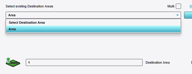

Click on "Select existing Destination Areas based on Attribute".
Selecting Destination Areas based on Attributes.

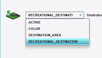

This will show a dropdown with which to select the Attribute marking the Areas to be used as destinations for the calculation.
The dropdown for selecting Attributes.
Change the dropdown to "RECREATIONAL_DESTINATION", the Attribute previously added to the Area created earlier.
The changed Attribute selection.

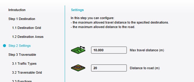

This step allows for setting the numerical parameters for the Travel Distance Overlay's calculation. There are 2 parameters available, the most important of which is the Max travel distance.
Set the "Max travel distance" to 400 (m).
The travel distance changed to 400 meters.
These are all the configurations needed for a minimal travel distance calculation.

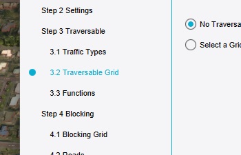

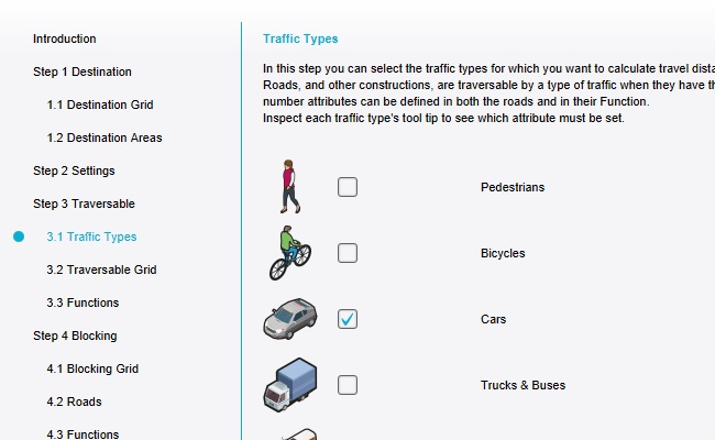

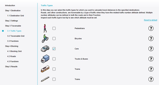

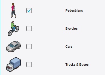

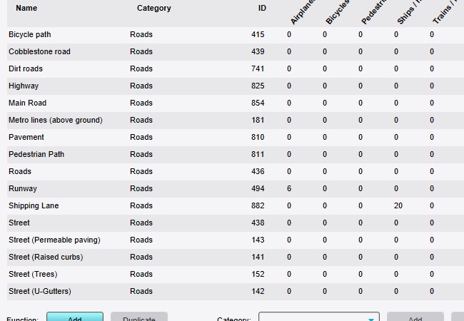

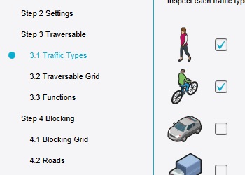

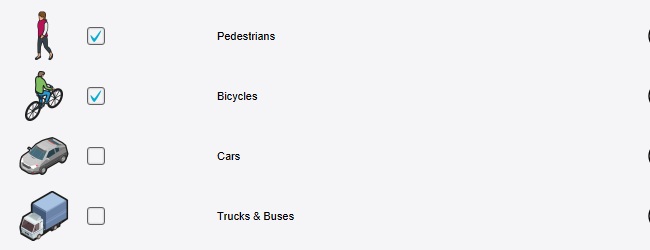

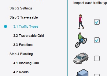

For the sake of insight, continue to the step regarding Traffic Types (skipping over any intermediate steps).
The Traffic Types step.
This step allows for the configuration of which mode of travel should be taken into account for the Travel Distance Overlay's calculation. By default, travel by cars is the selected mode of travel. This is the default because it is the most clear based on default data sources. Any road with cars on it is taken into consideration.

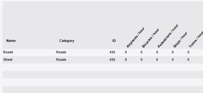

Although it is possible to configure the Travel Distance Overlay to take into account (or use exclusively) any other mode of travel as well, additional configrations elsewhere in a Project will be required to set those up properly. Therefor, it is often more efficient (and a good enough indication) to use cars as mode of travel for a general indication of reachability.
(This relies on the assumption that in urban environments where cars can travel, most car routes are accompanied by routes for pedestrians and bicycles.)

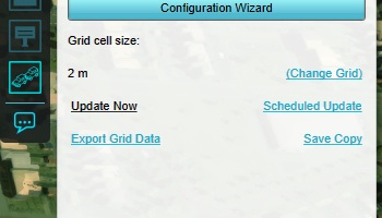

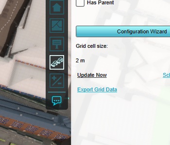

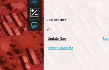

With the Travel Distance Overlay now configured, click on "Update Now" to let the Project recalculate.
Click on "Update Now" to recalculate the Overlay.

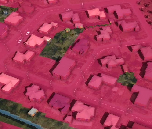

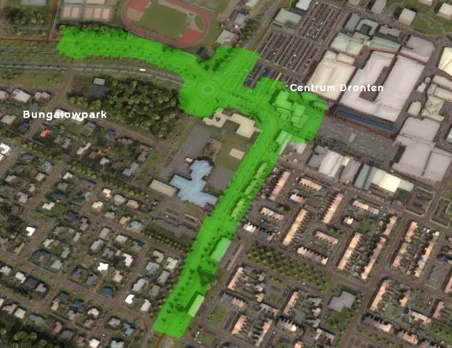

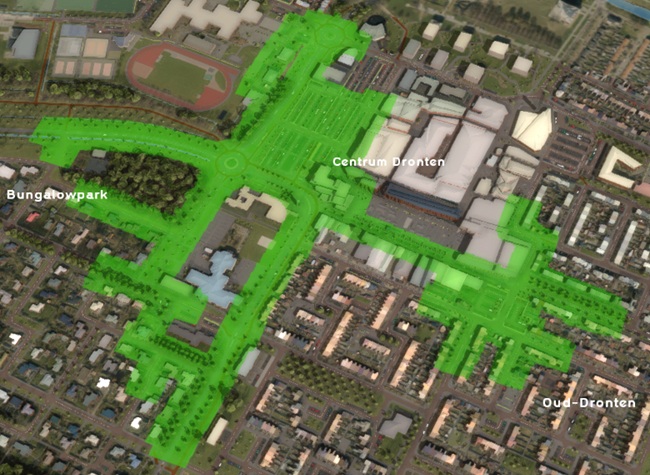

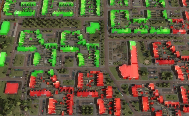

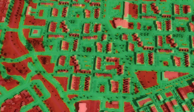

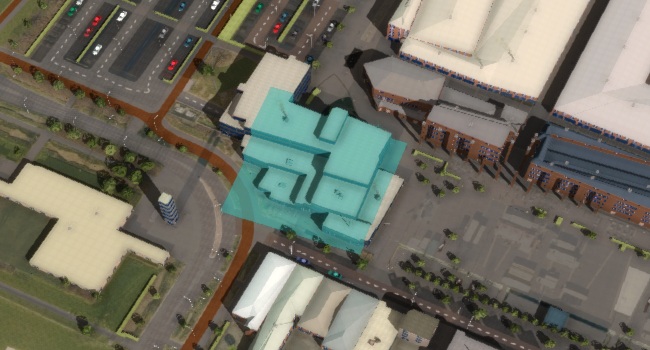

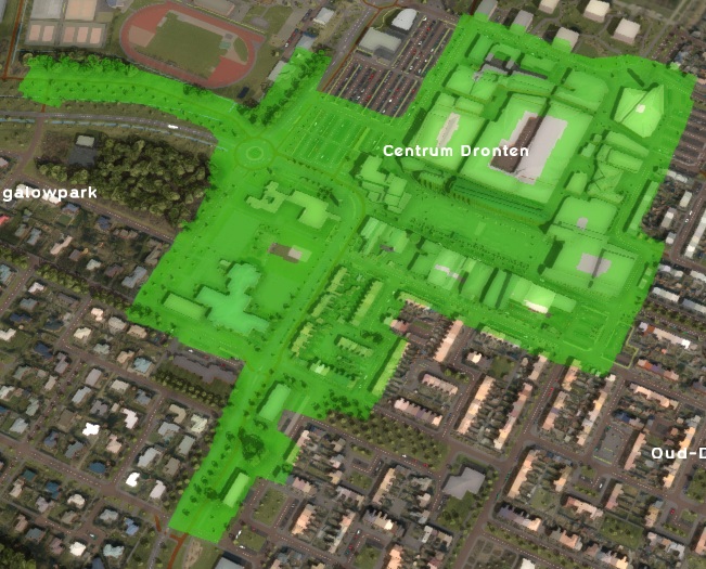

The Overlay will show results in the form of a blob, spread out starting from the Destination Area and propagating over the roads, with a buffered distance from the route it has traveled.
The results of the Travel Distance Overlay.
All locations in this blob can be reached from the previously defined Destination Area, and when starting from any of those locations it is possible to reach the Destination Area.
The buffering is so that the end-result of the calculation is not merely which parts of the road network are reachable (or within reach), but that the results actually "hit" the Buildings nearby. This means the results can be used directly to match with specific Buildings and whether those Buildings are in range of a Destination Area.
A close-up of the calculation results. The found routes are buffered to "cover" nearby Buildings.
For one Destination Area result, it will be a single color spread out. When multiple discrete Destination Areas exist, each Area will result in a unique value and coloring, showing which Destination Area is effectively "closest" or "most immediately reachable".

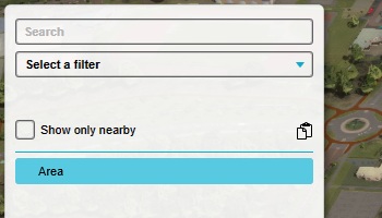

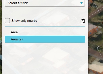

Reopen the list of Areas.
The list of Areas.

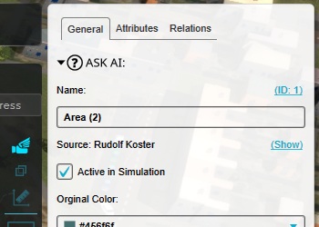

Adding another Area.
A new Area added.
The second Area's details.
The option to draw the Area in the Project.

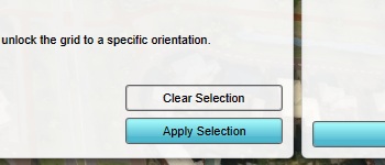

The option to confirm the drawn selection.

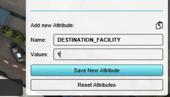

  • Name: DESTINATION_FACILITY
  • Values: 1
New Attribute information.
The option to save the new Attribute.
This will now serve as the marker for a Point of Interest.

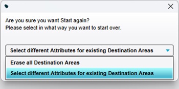

To change the Areas being considered for Destination Areas, the setting for Destination Areas has to be reset.
Click on "Reset" on the right side of the wizard.
The "Reset" option for Destination Areas.

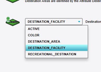

Opt to select different Attributes for determining Destination Areas, and confirm by clicking "OK".
Opt to select a new Attribute for recognizing Destination Areas.
Change the dropdown to "DESTINATION_FACILITY", the Attribute added to the newly created Area.
Select the new Attribute in the dropdown.
Click on "Next" to confirm the change.
"Next" will confirm the new selection.

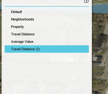

Finish and exit the wizard, and recalculate the Overlay.
Notice that with this Destination Area drawn as it is, it only effectively highlights the location where the Destination lies, but the calculation does not traverse the potential routes away from it.
The Travel Distance Overlay result is isolated from the traversable network.
It does still apply the buffering at the end of the travel distance calculation, despite not having traveled.

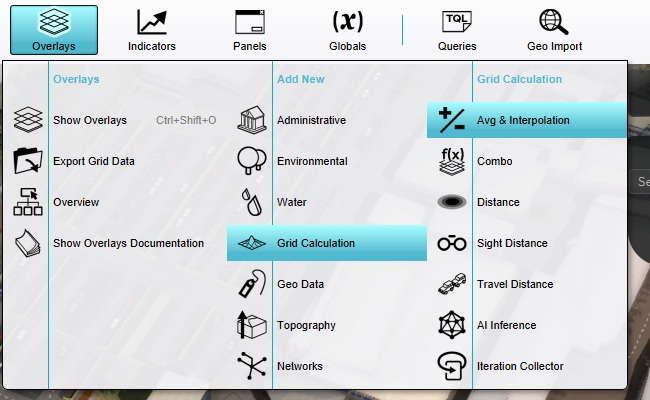

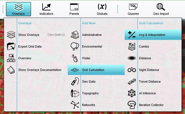

Add an Average Overlay.
Editor → Current Situation (Ribbon tab) → Overlays (Ribbon bar) → Grid Calculation (Dropdown) → Avg & Interpolation
Add an Averaging Overlay

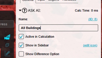

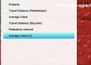

A new Average Overlay is now added, and selected in the left panel.
The new Average Overlay is listed.

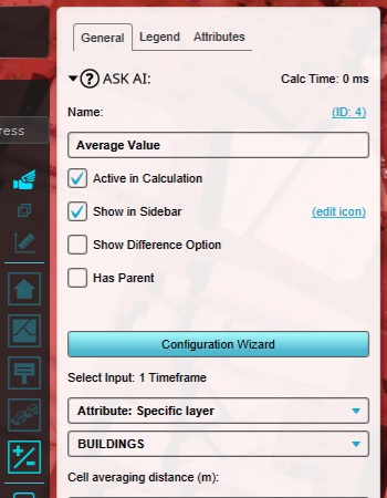

The details of the Average Overlay are displayed.

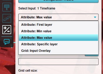

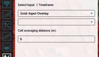

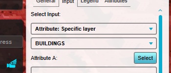

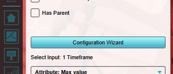

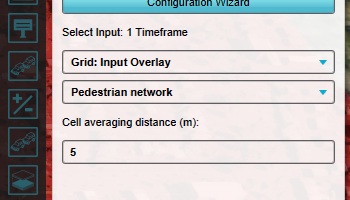

Set the input layer to "Attribute Max Value"
Opt to find the highest value among layers and use that as the value for the calculation.
Set the cell averaging distance to 30 meters.
The averaging distance effects a buffering around whichever sources are defined.
Set the Attribute to "DESTINATION_FACILITY".
The Average Overlay will now look for the Area indicating a Point of Interest.

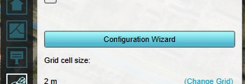

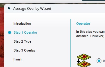

Open the Average Overlay's Configuration Wizard.
The button to open the Configuration Wizard.

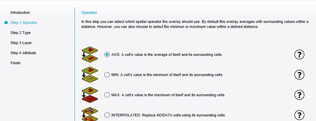

Continue to the "Operator" step.
The "Operator" step dictates how the Average Overlay computes a result.

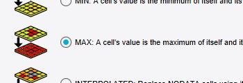

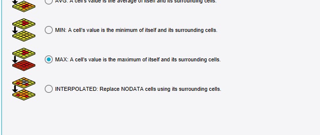

Select the "MAX" value operator.
The MAX value operator will use the highest value within the defined buffer.

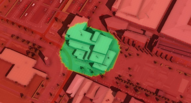

Take notice of the results in the Average Overlay. Although the source data (the Area) is effectively a point, the Average Overlay extends or buffers the data automatically. Because the operator is set to MAX rather than AVG, the "high" 1 value is used everywhere in the area surrounding the Destination Area.
The Overlay now cleanly buffers the Point of Interest to touch the traversable network.

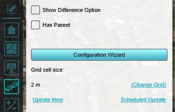

Reselect the Travel Distance Overlay.
Select the Travel Distance Overlay in the left panel.
Open the Travel Distance Overlay's Configuration Wizard.

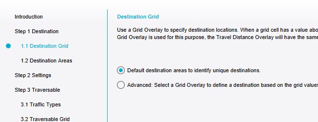

Continue to the "Destination Grid" step.
The step for defining a Grid as input for Destinations.

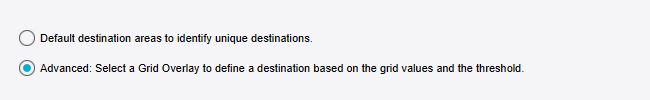

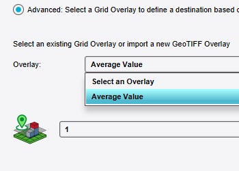

Opt to use a Grid Overlay as input for destinations.
The option to use a Grid Overlay for destinations.
As input Overlay, set the Average Overlay created previously.
Selecting the Average Overlay in the dropdown.

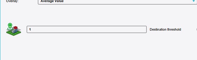

Take note of the "Destination threshold". Cells in the input Overlay with values at or above this threshold are considered (part of) destinations to calculate travel distances to.
The destination threshold defines at which value cells in a Grid Overlay constitute a destination.
Since the Attribute was created with a value of 1, the Average Overlay uses a MAX operator to retain that value across multiple cells, and the default threshold value is also 1, no changes to this value are neccesary.

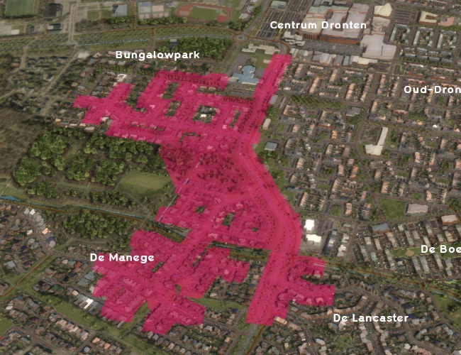

Notice that now, rather than the smaller drawn Area resulting in only a highlighting of the direct environment of the point of interest, the larger highlighted area of the Average Overlay is used, touching the traversable network and as such creating a proper Travel Distance calculation.
Starting from the point of interest, now touching the traversable network, travel distances are calculated.
Note that if you do not see this result yet, the most likely cause is the Average Overlay is using an "Averaging Distance" which is too low to touch the traversable network. If neccesary, increase the cell averaging distance and recalculate again.
With the possibility to connect Grid Overlays to the Travel Distance Overlay to define destinations, increasingly more complex inputs can be created, including the ability to fully calculate destinations on-the-fly.

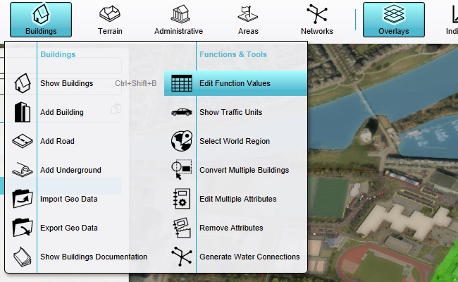

Open the Function Values Table.
Opening the Function Values overview from the Buildings dropdown.
This window allows for configuring the default values and properties of Buildings, including the amount of traffic for various modes of travel.
The Function Values window.

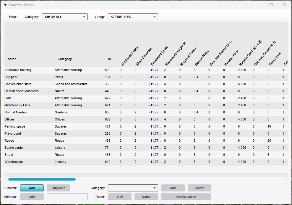

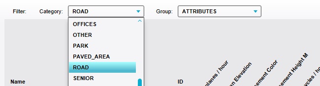

At the top of the window, set the "Category Filter" to the ROAD Category.
Selecting a Category of Function to filter the view on.

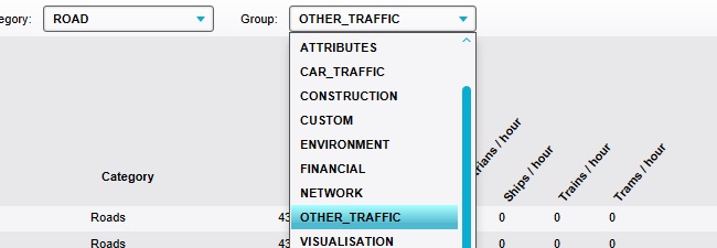

Next, set the "Group Filter" to OTHER_TRAFFIC.
Selecting a group of Function Values to filter on.
These filters ensure the oveview is a compact overview for exactly the values to be edited.
A limited overview of values.
The default overview of Functions does not immediately show all possible Functions. More often than not, Functions should be explicitly added to this overview so they can be edited.
At the bottom of the Function Values window, find the "Add" Option for Functions.
The option to add additional Functions to the overview.

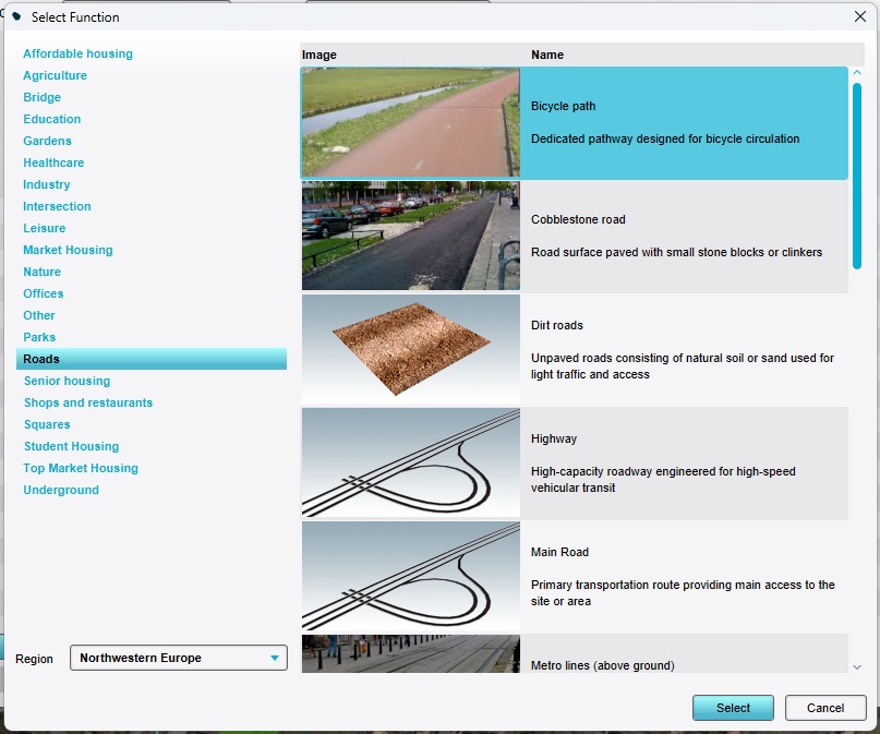

A Function Selection window will open.
The window to select additional Functions for the overview.

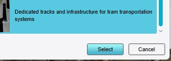

Switch to the Roads category, and select all Functions in that category.
Selecting all functions in the Roads category.
Click on "Select" to confirm the selection.
The option to confirm and process the selection.
The Functions are now added to the overview.
The list of Functions has now expanded to include the selected Functions.

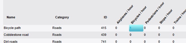

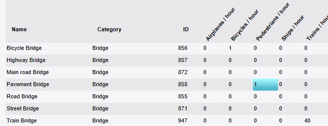

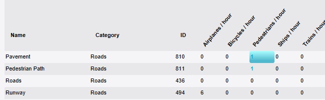

For all Functions on which pedestrians could travel, set the "Pedestrians / Hour" to at least 1.
Functions which should allow for pedestrians have adjusted values.
For all Functions on which bicycles could travel, set the "Bicycles / Hour" to at least 1.
Functions which should allow for bicycles have adjusted values.

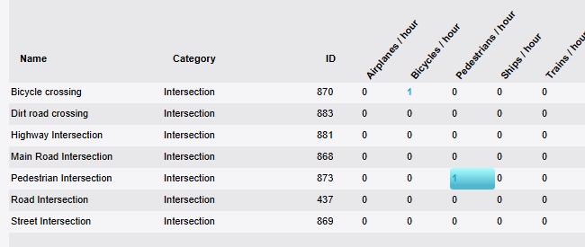

Change the Category filter to "INTERSECTION", again add all Functions of that category, and configure them with the appropriate "Pedestrians / Hour" and "Bicycles / Hour" vales.
The values set for intersections.
Change the Category filter to "BRIDGE", again add all Functions of that category, and configure them with the appropriate "Pedestrians / Hour" and "Bicycles / Hour" vales.
The values set for bridges.

Next, the Travel Distance Overlay can be modified so that it is focussed specifically on those modalities.
The option to open the Configuration Wizard.
Continue to the step regarding Traffic Types.
Ensure Pedestrians and Bicycles is checked. Ensure Cars and all other options are unchecked.
Pedestrians and bicycles selected as intended modalities.
Close the Configuration Wizard.

The Travel Distance Overlay results are now different, more closely alligned with the routes for pedestrians and bicyclists.
Newly calculated routes, now on pedestrian- and bicycle traversable routes.
Editor → Current Situation (Ribbon tab) → Overlays (Ribbon bar) → The Travel Distance Overlay (Left panel)
The Travel Distance Overlay selected.

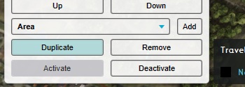

At the bottom of the left panel, click on "Duplicate".
The option to duplicate an existing Overlay.
There is now a second Travel Distance Overlay.
A second Travel Distance Overlay is listed.

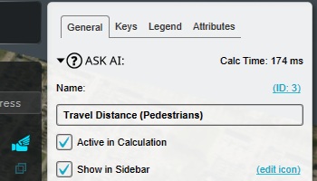

With the first Travel Distance Overlay selected in the left panel, find the "Name" input in the right panel.
The details of the first Travel Distance Overlay.
Rename this Overlay to "Travel Distance (Pedestrians)".
The Travel Distance Overlay renamed.
Open the Travel Distance Overlay's Configuation Wizard.
The step for Traffic Types.
Ensure only Pedestrians is checked. Ensure Bicycles and all other options are unchecked.
Only pedestrians are now selected. All other modes of travel are unselected.

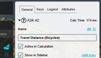

With the second Travel Distance Overlay selected in the left panel, find the "Name" input in the right panel.
The details of the second Travel Distance Overlay listed.
Rename this Overlay to "Travel Distance (Bicycles)".
Ensure only Bicycles is checked. Ensure Pedestrians and all other options are unchecked.
Only bicycles are now selected. All other modes of travel are unselected.

Add an Combo Overlay.
Editor → Current Situation (Ribbon tab) → Overlays (Ribbon bar) → Grid Calculation (Dropdown) → Combo
Adding a Combo Overlay.
A new Combo Overlay is now added, and selected in the left panel.
A new Combo Overlay is listed and selected.

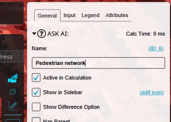

Rename it to "Pedestrian network"
The Overlay renamed.

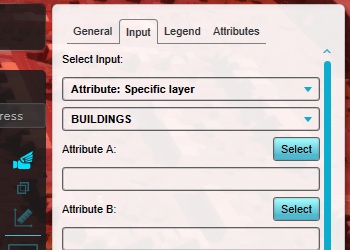

In the right panel, switch to the "Inputs" tab.
The Inputs tab.

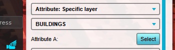

Ensure the input layer is set to "BUILDINGS".
The setting for the layer to obtain Attributes from.

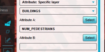

Set Attribute input A to "NUM_PEDESTRIANS".
The Attribute A input now reads the Function Value for pedestrians from Buildings.

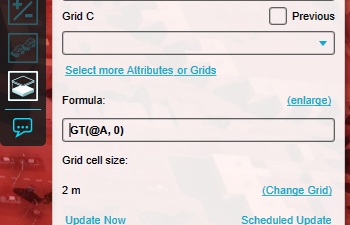

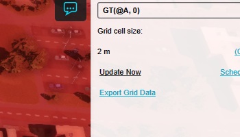

Set the formula to "GT(@A,0)"
The formula showing either a value or not.

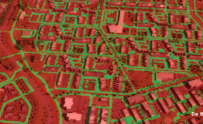

Recalculate the Project.
The option to recalculate the Project.
This Overlay now highlights the locations of the pedestrian network as a Grid.
A highlighting of the pedestrian network.
Adding an Average Overlay.

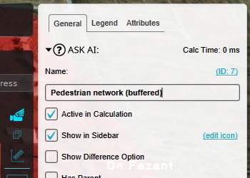

Rename it to "Pedestrian network (buffered)"
The Overlay is renamed.

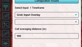

Set the input layer to "Grid Overlay"
Opt to use a Grid Overlay as an input for the Average Overlay.
Set the cell averaging distance to 5 meters.
5 meters of buffering means gaps of at most 10 meters can be bridged/filled in.
Set the input Grid Overlay to the previously created "Pedestrian network" Combo Overlay.
The pedestrian network is now selected as an input grid.
The Operator step.
The "MAX" value operator will use the highest value found in the buffer area.
Close the Average Overlay's Configuration Wizard.
Continue to the "Traversable Grid" step.
Selecting the step for the Traversable Grid.

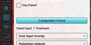

Opt to select a Grid Overlay as input for traversables.
Opt to select a Grid Overlay for the traversable network.
Select the "Pedestrian Network (buffered)"
The Overlay with the buffered pedestrian network is selected.
By setting a traversable prequel, the settings for the traffic types are automatically disregarded.

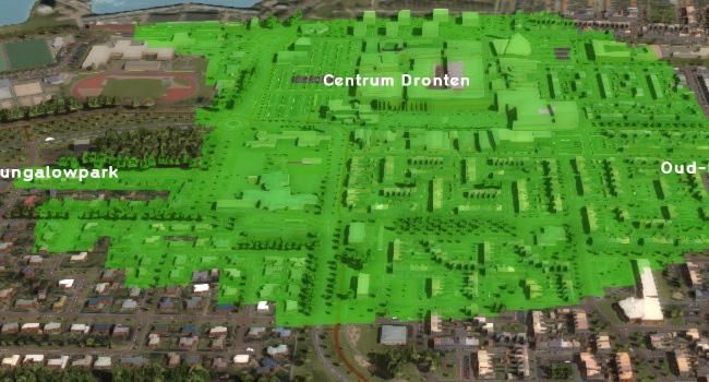

Notice the pedestrian travel distances now cross the gaps that they previously did not.
The Travel Distance Overlay's results are now more expansive, as the traveler can reach more places with the buffered network.

Rename it to "All Buildings"

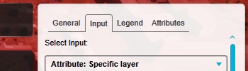

The inputs tab.

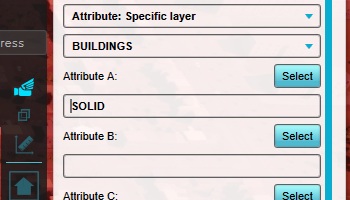

The BUILDINGS input layer selected.

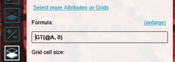

Set Attribute input A to "SOLID".
The "SOLID" Attribute of Buildings is set as Attribute input A.
Switch back to the "General" tab.
Switched back to the General tab.
A formula to show whether there's a value or not.

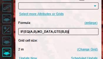

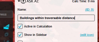

Rename it to "Buildings within traversable distance"
The new Combo Overlay renamed.

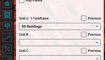

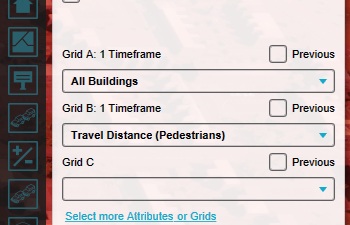

Set Input A to "All Buildings".
Input A is the Grid of Buildings.
Set Input B to "Travel Distance (Pedestrians)".
Input B is the Grid of reachable locations by the Travel Distance Overlay's calculations.
Set the formula to "IF(EQ(A,0),NO_DATA,GTE(B,0))"
If there is no Building, leave the output empty. Otherwise (if there is a Building), determine if it's within reach.
This formula will check where solid Buildings exist. Any place where they do will compute either a 0 or a 1, depending on the travel distance result. All places that are not solid Buildings will not output any value.

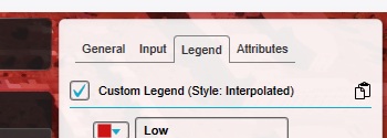

Switch to the "Legend" tab, and activate the "Custom Legend"
The Legend tab, and the Custom Legend option activated.
Remove all entries (if any) and add 2 new ones.
Two new empty Legend entries.

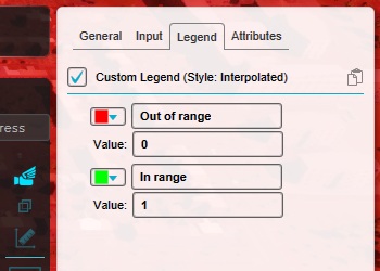

Change one of the legend entries as follows:
  • Value: 0
  • Color: Red
  • Text: Out of range
Change the other legend entry as follows.
  • Value: 1
  • Color: Green
  • Text: In range
A configured custom legend.
The result is an Overlay which shows which buildings are in range of the indicated destinations.
An Overlay which shows which Buildings are in travel range of the specified Point of Interest.
