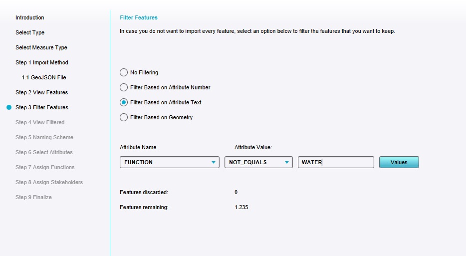

Filter features
When importing a file, but with the intent of only importing a subset of the included features, it is possible to apply a filter on the features. The filter functions as a whitelist. I.e. when a filter is applied, the features matching the filter are imported. A common occurrence can be that the plan also includes Water, which should not be imported as a Building. If this is the case, set up a filter which checks the attribute indicating whether or not a feature has water, and ensure that the filter matches features which are not water.
Example of a filter to exclude data from an import.
If a filter is applied, the next step is another opportunity to view the resulting features. If there are features missing, or incorrectly added, it is possible to go back to previous steps and make changes.

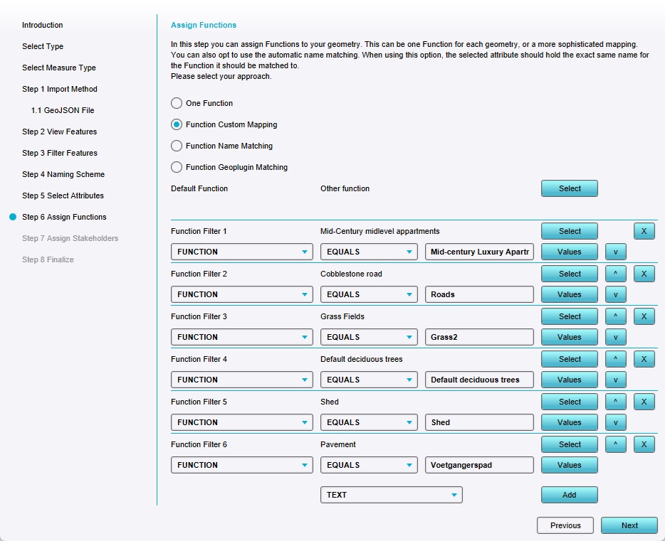

This is the most important step of the import process, as this is where the translation is defined between what data is in the urban plan file, and how that data should be interpreted into specific types of Buildings. Building types are known as Functions in the Tygron Platform.
There are a number of options available, described here for clarity:
One Function
When the dataset only contains one kind of feature, such as a dataset of trees, a single "Default Function" can be selected.
Function Custom Mapping
This option allows for creating a number of on-the-fly rules for importing the data, based on the values of Attributes attached to the Feature. When a feature matches one of those rules, that rule defines which Function the Building becomes. When a feature does not match any of the rules, a default Function is applied.
Function Name Mapping
This option is applicable when the features in the data have an Attribute which has a value which exactly matches the name of a Function in the Tygron Platform. This allows the Tygron Platform to directly match the imported features to the Functions in the Tygron Platform.
Function Geo Plugin Matching
Geo Plugins are a more advanced but most preferred route for importing data. They are a separate type of Item which are specifically a collection of rules to match/translate incoming data to specific Items in the Tygron Platform.
For now, select "Function Custom Mapping". This option will allow you to create a few import rules on-the-fly.
The Function mapping step.

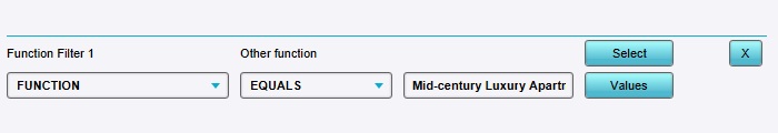

At the bottom, ensure the drop-down is set to "TEXT", and click "Add" to add a rule.
Option to add filters for mapping Functions.
A "Function Filter" appears. It consists of a number of options to help define the rule.
The added, unfilled filter.
For the first drop-down, select the Attribute the rule should look at.
There is no standard for the Attribute name to relate to a type of building, and the Attribute to use depends on the data provider.
Ensure the second drop-down is set to "EQUALS".
The third input is a text input field. You can type here directly, or click on "Values" for a listing of values found for this Attribute in the data. Click on "Values", and select and confirm one of the values.
The filled filter.
This has set up the test-part of the rule. Next, the effect can be defined. Click on "Select", and use the Function selection window to select an intended Function.
Function selection window.
As it stands now, when the features are processed, any feature with that Attribute, and that value for that Attribute, will become that function.
The filter now has a matching rule, and an effect.
Add an additional rule by clicking on "Add" at the bottom of the window again, and repeat the configuration steps. Repeat this process a few times so the most important features are mapped. (For the purpose of practice, it is not required right now to map all the features. A few is sufficient to see the effects further on.)
A list of filters so various features are mapped to various functions.
When a few rules have been defined, continue to the next step.
