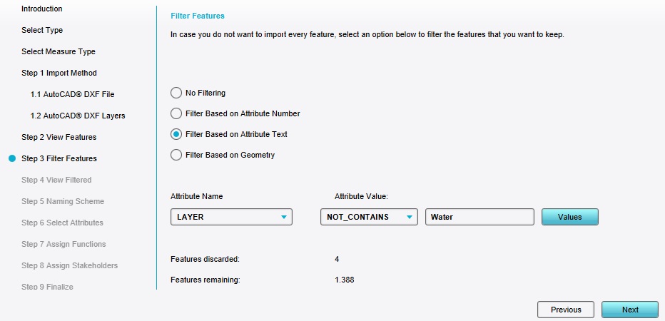

Filter features
When importing a file, but with the intent of only importing a subset of the included features, it is possible to apply a filter on the features. The filter functions as a whitelist. I.e. when a filter is applied, the features matching the filter are imported. A common occurrence can be that the plan also includes Water, which should not be imported as a Building. If this is the case, set up a filter which checks the attribute indicating whether or not a feature has water, and ensure that the filter matches features which are not water.
Example of a filter to exclude data from an import.
If a filter is applied, the next step is another opportunity to view the resulting features. If there are features missing, or incorrectly added, it is possible to go back to previous steps and make changes.

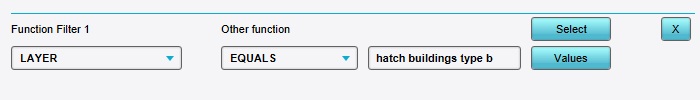

At the bottom, ensure the drop-down is set to "TEXT", and click "Add" to add a rule.
Option to add filters for mapping Functions.
A "Function Filter" appears. It consists of a number of options to help define the rule.
The added, unfilled filter.
For the first drop-down, select the Attribute the rule should look at.
In the case of DXF files, this is basically always the "LAYER" Attribute.
Ensure the second drop-down is set to "EQUALS".
The third input is a text input field. You can type here directly, or click on "Values" for a listing of values found for this Attribute in the data. Click on "Values", and select and confirm one of the values.
The filled filter.

  1. Expand the imported Measure with water, features for which are also defined in the DXF. Use:
    • the Geo Import Wizard,
    • the "Update existing Measure" option,
    • the "Terrains" type,
    • and a filter to select only the features in the applicable layer (indicated by the LAYER Attribute).
  2. (Optional): Go to Tools → Geo Plugins. In the left panel, select the "DXF Matcher" Geo Plugin, and in the right panel select the "GeoLinks" tab. Select some of the Geo Links and explore their configurations.
