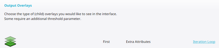

- With the Water Overlay Wizard opened, continue to the Output Overlays step.
- Click on the link named 'Iteration Loop', found on the right next to Extra Attributes.
- Read the Warning Dialog window, and confirm with Create Loop.
- Read the changes made to the project in the Message Dialog window, and confirm with OK.

The Iteration Loop link found in the Output Overlays step.
