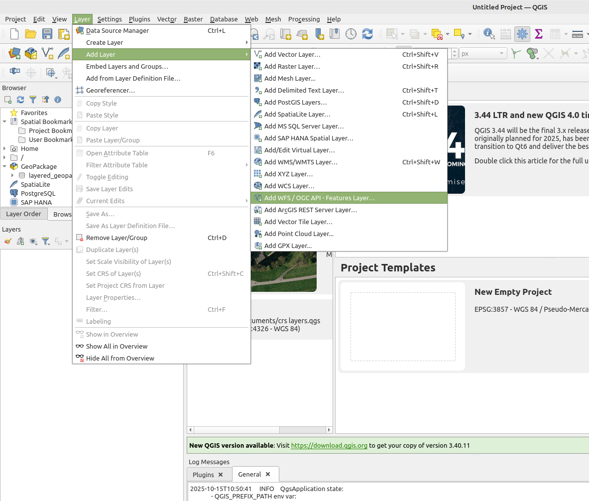

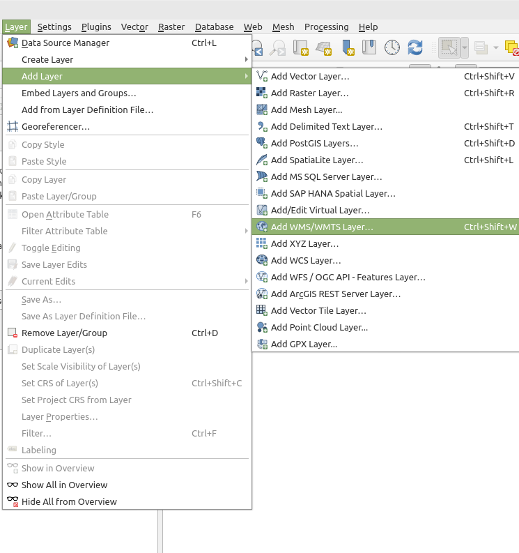

  2. In QGIS, Hover over Layer in the ribbon bar, and under add new Layer, select add WFS / OGC API Feature Layer

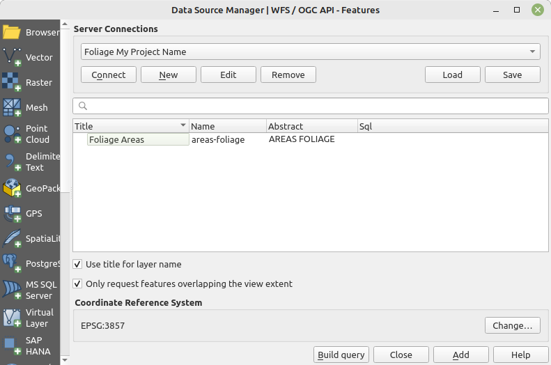

  3. In the Data Source Manager panel, select New.

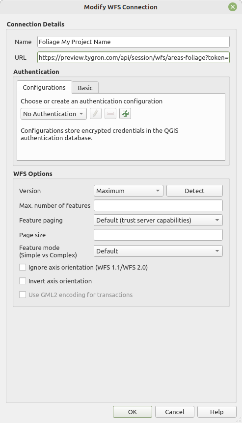

  4. Paste the copied WFS url from the Export Geo Data panel and paste it in the url field.
  5. Provide an appropriate name, for example Foliage - My Project Name and confirm.
  6. Click on the Connect button.
  7. Select the layer named Foliage Areas and click on Add.

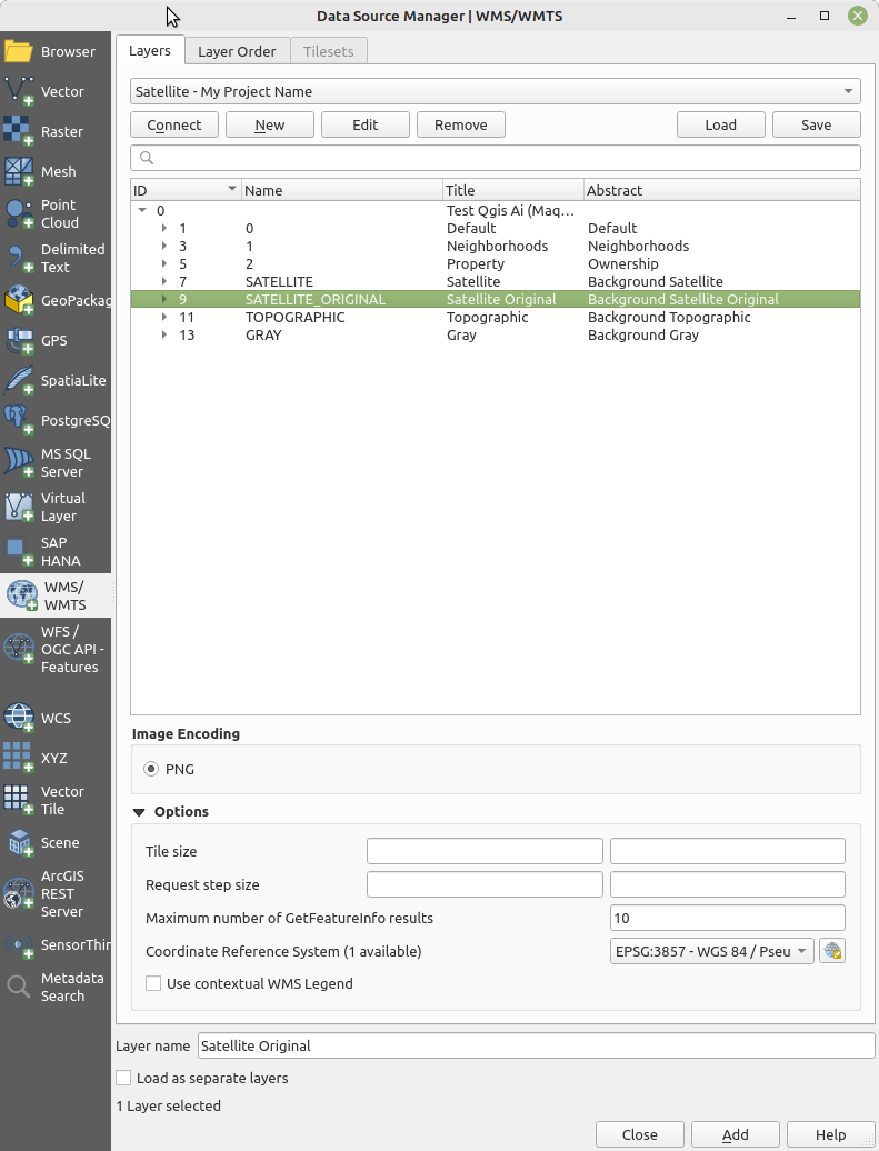

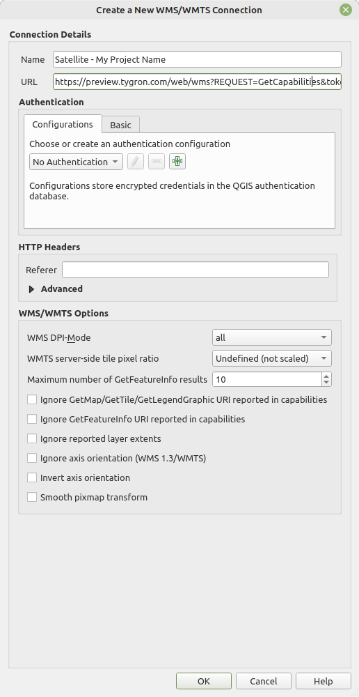

  10. In QGIS, hover over Layer again, and under add new Layer, select add WMS/WMTS.
  11. Click on add new.
  12. For the URL field, paste the copied Web Map Service (WMS) URL.
  13. For the name, write Satellite - My Project Name and click on OK to confirm.
  14. Click on connect and select the layer named SATELLITE ORIGINAL and click add.

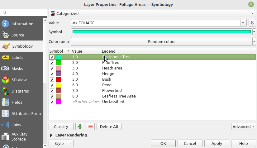

  3. Changed the type to Categorized.
  4. Click on the plus button to add 1 category per class and add a final extra one.
  5. Per type, do the following:
    1. Add an entry and provide it with an floating point number, such as 1.0.
    2. Select a color
    3. Provide the name of the entry with the classification, for example Deciduous.
  6. Finally, add a final entry with no value and a color that significantly different from the classification colors, such as pink or purple. Name this entry Other.
  7. Click on the apply button.

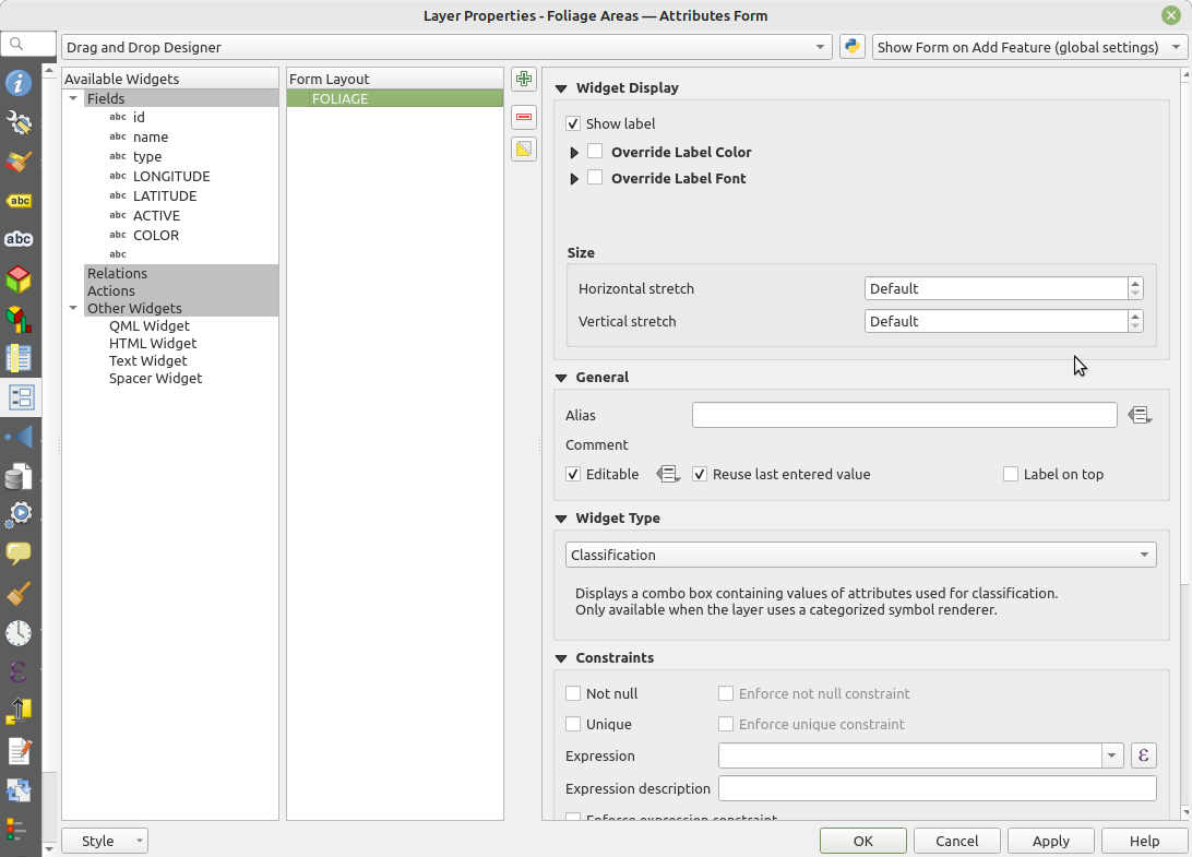

  8. Next select the tab Attributes Form
  9. Change the option to Drag and Drop Editor.
  10. Under form Layout, remove all fields except the FOLIAGE field.
  11. Select the FOLIAGE field, and under general, select the Reuse last entered value option.

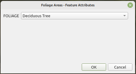

  12. Change the Text Field widget to Classification.
  13. Select apply to confirm.

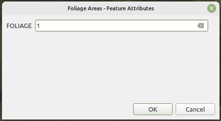

  5. Right click to confirm the shape. The feature form appears.
  6. Provide the correct value and click on the OK button. You can also confirm by pressing the ENTER key, and cancel with ESC.

  • You can choose to change the Attribute Form of the WFS Feature Layer to use the Classification instead of a text field with a number, in case the classification numbers are hard to remember.
