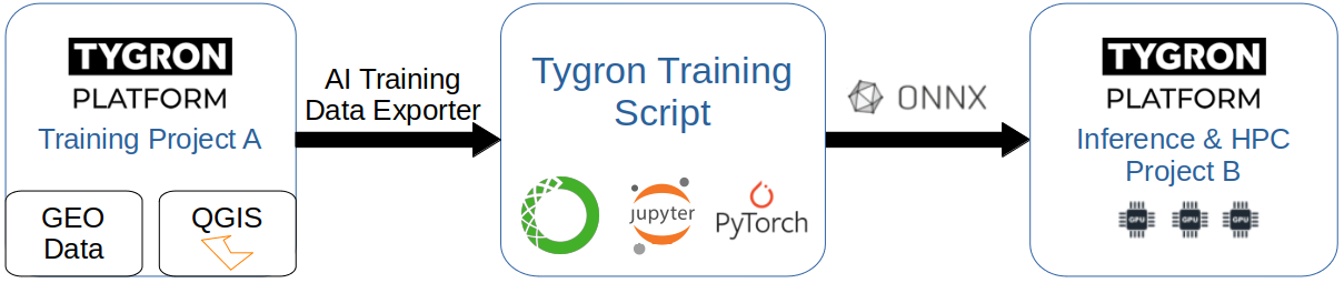

The Tygron AI Suite provides a comprehensive set of tools to assist you in all stages of creating, training, and utilizing your own RCNN within an Inference Overlay on our dedicated GPU cloud.
Creating your own model
Follow these steps to create an AI model based on a RCNN.
- Start with a definition of which objects you want to detect. For example trees, cars, solar panels, etc. These can also be subsets for example trees can also be subdivided into palms, pines, etc.
- Create one or more varied projects and manually define training data by outlining the target objects. Follow: How to create AI training data with QGIS
- Create two groups of objects a TRAIN and TEST dataset that can be exported. Follow: How to export AI Training Data
- After exporting you can start training your RCNN resulting in a ONNX file. Follow: How to train your own AI model for an Inference Overlay.
- Import the ONNX back into the Tygron Platform as a Region-based Convolutional Neural Network and assign it to an Inference Overlay. For example: How to detect foliage using an Inference Overlay
- Finally validate the results on a different project and iterate back to a previous step if needed. Follow: How to evaluate an AI model
Apply a model
- Apply a custom-created or existing ONNX file as a Region-based Convolutional Neural Network for other projects with the Inference Overlays. For example: How to detect foliage using an Inference Overlay
