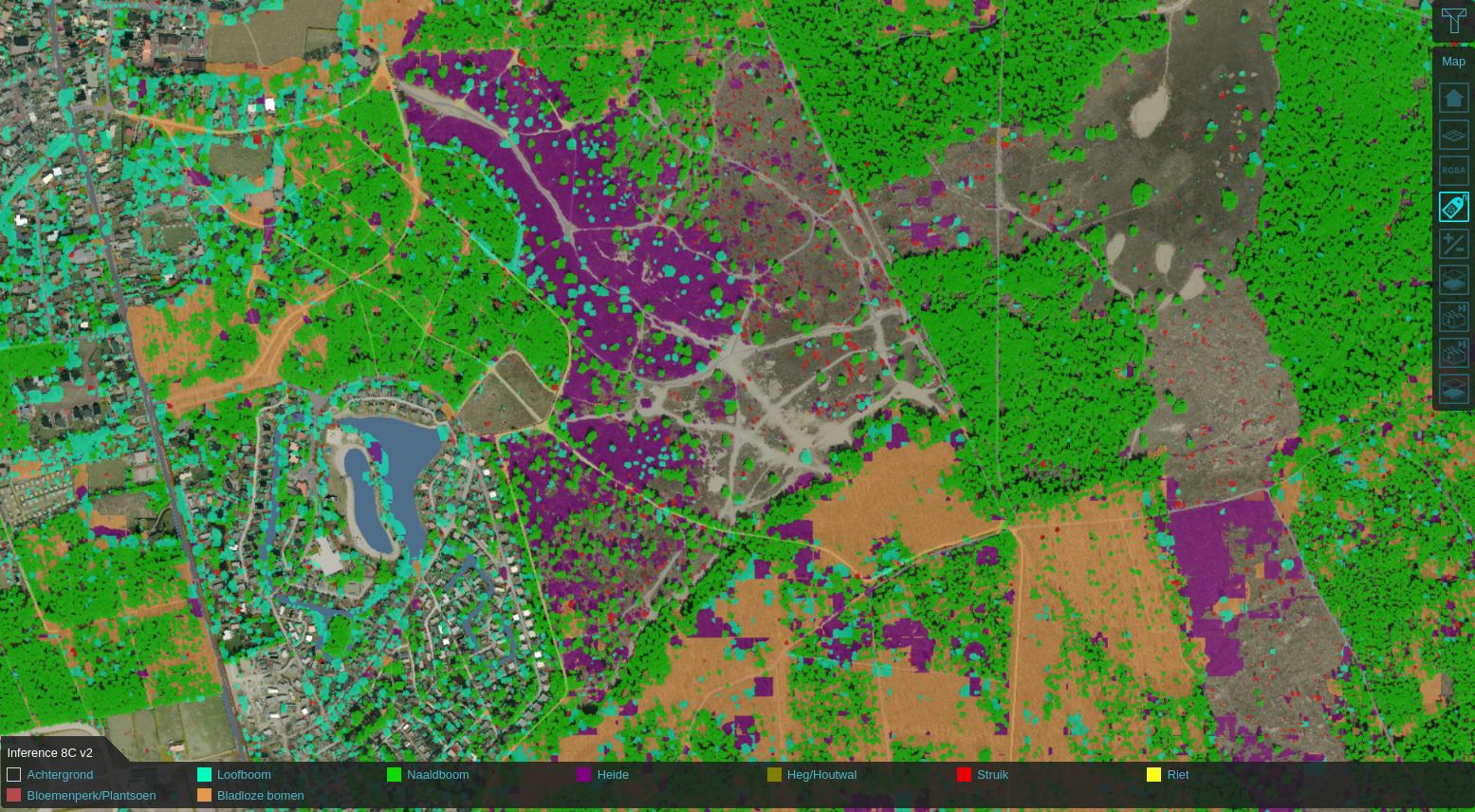

AI can be a strong tool to enhance, reinforce, and analyze a variety of datasets for a variety of cases. However, the training-based approach for creating an AI model means that evaluating the performance and results of such a model requires explicit validation. For this purpose, after training an AI model with the appropriate training- and testing datasets, it should be set to analyse a third, separate, "evaluation dataset" to validate its accuracy.
The best method for this evaluation is to compare the geographical results of the Inference Overlay running the model with an Average Overlay or Combo Overlay displaying the known dataset.
