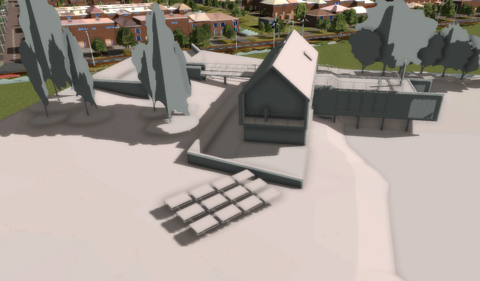

Example IFC created by Revit.

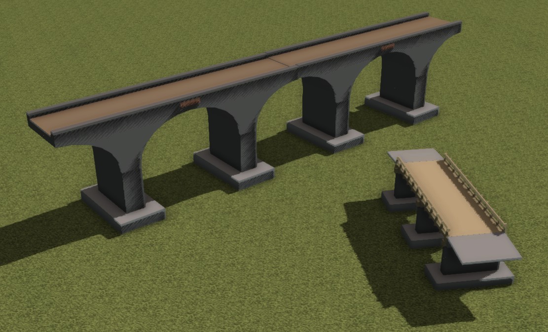

Example IFC of a bridge with colored faces.
