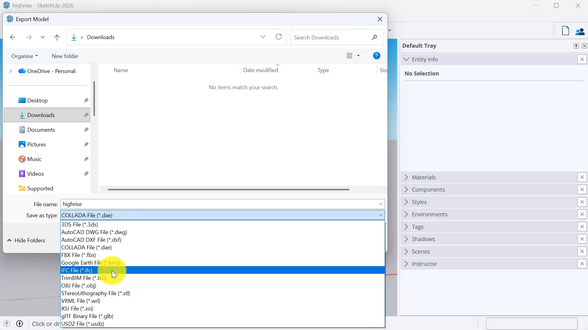

  3. When ready to export go to file -> Export model.
  4. In the export dialog choose IFC as export type.
