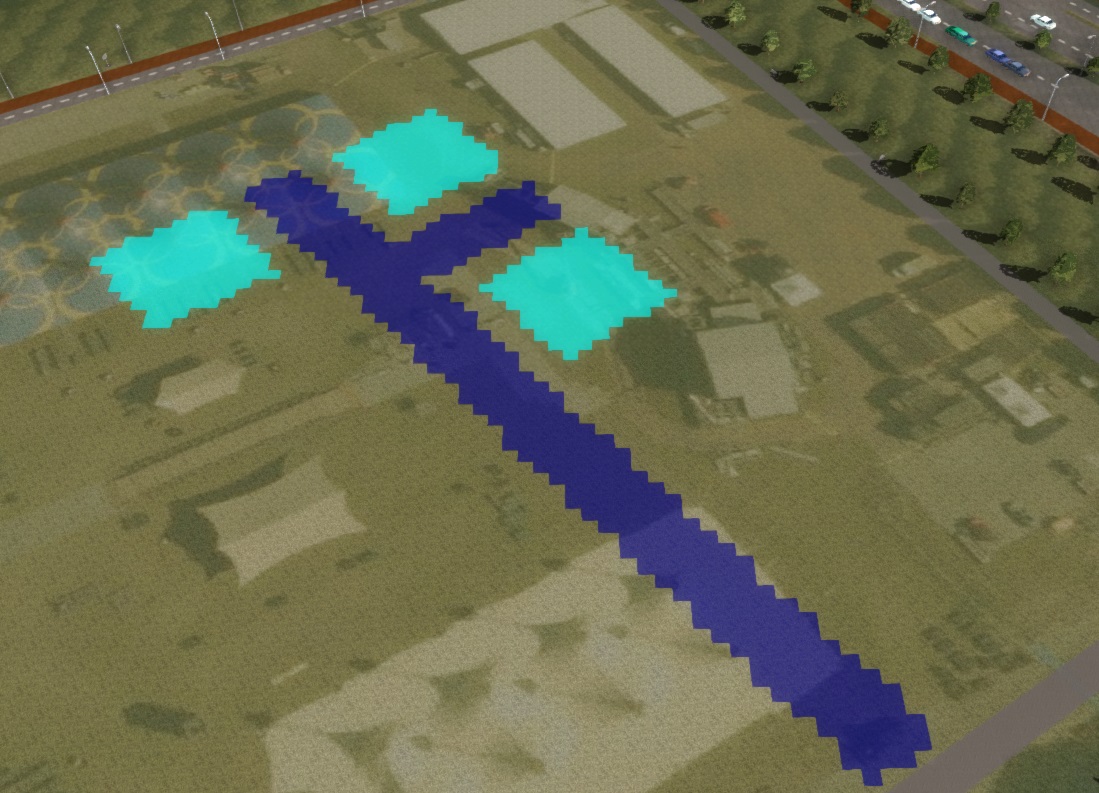

A Grid Overlay with height increases and height decreases defined

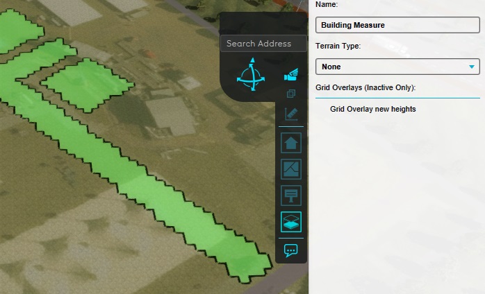

The Grid Overlay added in the list of GridSpatials of the Measure

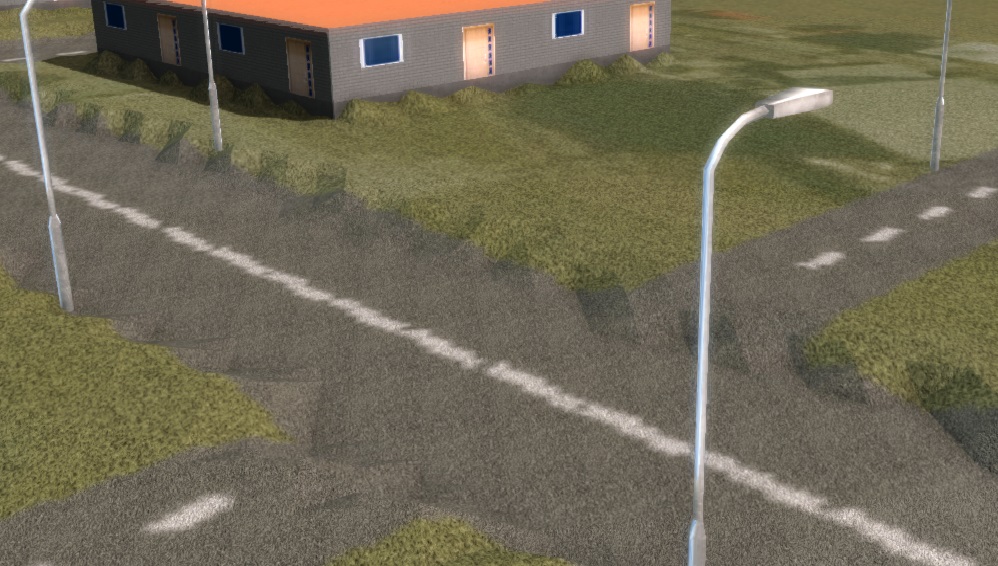

The locations of the main road and buildings had different elevations defined. The side roads are placed on the height map as-is.
