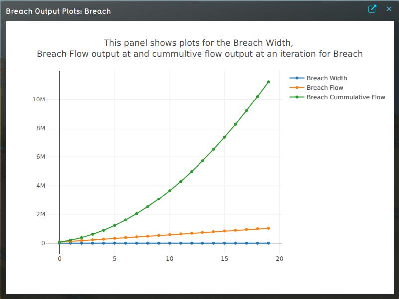

The Template Text panel uses a simple HTML div element and javascript to plot a chart of 3 traces: The Breach Area Width at, Flow at and Flow Sum at. This panel obtains these values by simply requesting the respective attributes of the Breach Area that is linked to the Text Panel instance, using $ATTRIBUTE_BREACH_WIDTH_AT.
