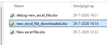

Create a new [[Excel]] file, and save it locally to your computer. Ensure it is located in a place where you are able to find it later.
[[File:Indicator tutorial 01 01 new excel.jpg|frame|center|TODO]]
[[File:Indicator tutorial 01 01 new excel.jpg|frame|center|A new Excel file.]]

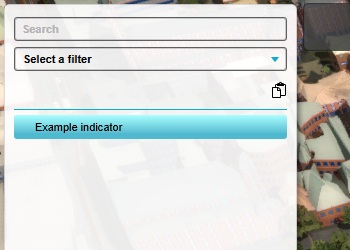

The [[left panel]] is now open with a list of all [[Indicator]]s in the [[Project]]. The newly added [[Indicator]] is already listed.
[[File:Indicator tutorial 01 07 indicator left.jpg|frame|center|TODO]]
[[File:Indicator tutorial 01 07 indicator left.jpg|frame|center|The new Indicator is listed.]]

{{editor location|Indicator|Example indicator}}
[[File:Indicator tutorial 03 09 Select the indicator.jpg|frame|center|TODO]]
[[File:Indicator tutorial 03 09 select the indicator.jpg|frame|center|Select the Indicator in the left panel.]]

Note that as a matter of good practice, the debug file should ''not'' be reuploaded to a [[Project]]. This has to do with the undue presence of data in [[Indicator]]s. This will be further clarified later on.
[[File:Indicator tutorial 03 15 right file.jpg|frame|center|Debug file is named with a "debug-" prefix, unless renamed. Make sure you know which file is which.]]
If insight into the debug [[Excel]] file leads to a change in the content of the [[Excel]] file, update the original file instead. Download and open the "original" [[Excel]] file from the [[Asset]]s overview as done previously, make the desired changes there, and re-upload the file.

Click on the [[Indicator]] in the [[top bar]], to open the [[indicator panel]].
Line 431: Line 467:
Notice that the result in the [[Indicator]] has changed, to reflect the changed situation in the [[3D Visualization]].
[[File:Indicator tutorial 03 30 changed results.jpg|frame|center|TODO]]
[[File:Indicator tutorial 03 30 changed results.jpg|frame|center|The changed results in the Indicator.]]

The left panel is now open with a list of all Indicators in the Project. The newly added Indicator is already listed.

When the calculation has completed, click on the Indicator in the top bar.
The top bar shows the Indicator and its "calculated" score.
This opens the Indicator panel.
The Indicator panel's output as defined by the EXPLANATION cell, and displaying a score as defined by the SCORE cell.
Notice the following elements in the interface:
  • The Indicator panel displays the full name of the Indicator.
  • The Indicator panel displays the text entered in the EXPLANATION cell.
  • The Indicator panel displays a score percentage of 80%, matching the "0,8" value for the score.
  • The top bar displays the short name of the Indicator, due to the potentially limited space for display.
  • The top bar displays a score bar, which graphically shows a score of 80% due to the bar being 80% filled.
Effective use of these outputs relies on matching the intent of the outputs with the information provided.
  • The score of the Indicator should be a computed net-result of the particular theme the Indicator describes.
  • The explanation should be a clarification on what that score is composed of, and what the various sub-scores are (if applicable).

The debug file can be saved on your local computer.
Use the file save screen to save the file to a location on your computer. Remember the location where you save the file.
When the download has completed, open the Excel file in Microsoft Excel. You will see that this file contains actual values from the Project.
The debug file is the same as uploaded, except the TQL-named cells have as a value the actual results of the TQL statements.
Note that as a matter of good practice, the debug file should not be reuploaded to a Project. This has to do with the undue presence of data in Indicators. This will be further clarified later on.
