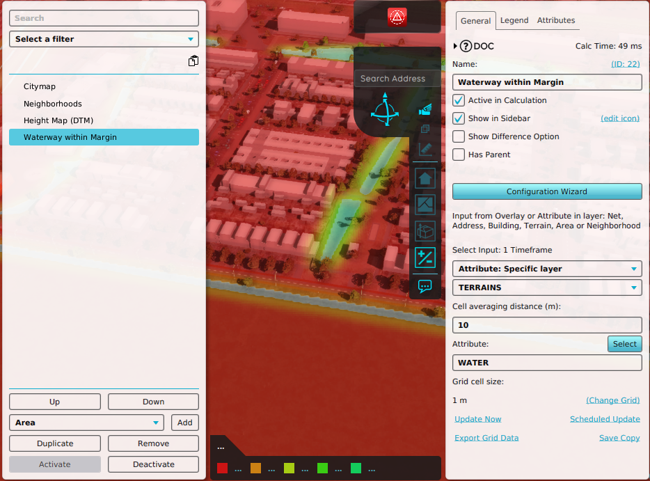

  5. With the Average Overlay selected, rename it to Waterway within Margin
  6. Under Select Input, set the option to Specific Layer and select the TERRAINS layer type.
  7. Set the Cell average distance to 10 meters
  8. Click on the Select button and select the WATER attribute from the list of Terrain attributes.

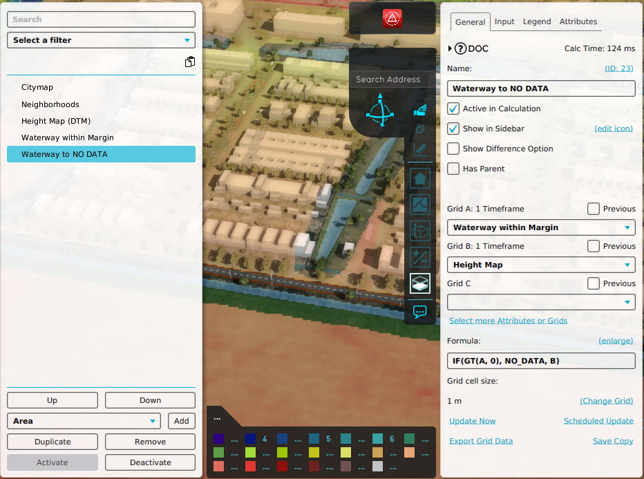

  9. Hover over Overlays in the ribbon bar and under Grid Calculation, select Combo Overlay
  10. With the Combo Overlay selected, name it to Waterway to NO DATA using the Detail Panel
  11. For Grid A, select the overlay named Waterway within margin
  12. For Grid B, select the Digital Terrain Model Overlay named Heightmap
  13. Provide the following formula: IF(GT(A, 0), NO_DATA, B)

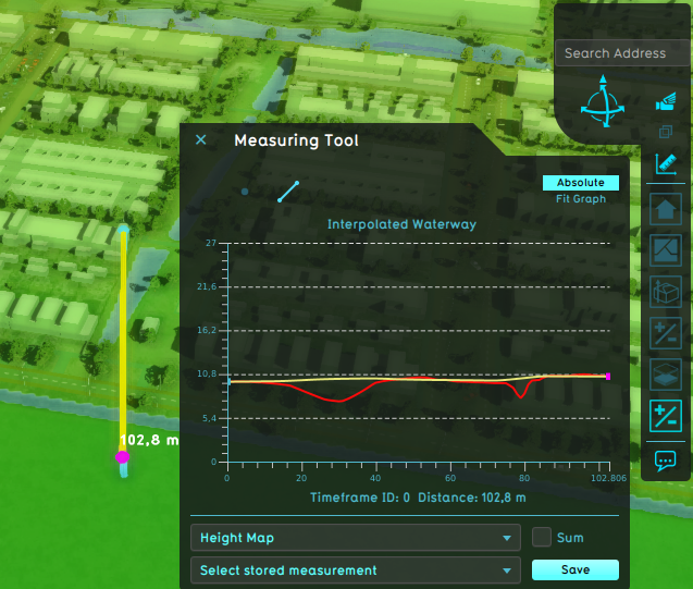

  14. Hover over Overlays in the ribbon bar and under Grid Calculation, select Avg and Interpolation
  15. Rename the Average Overlay to Interpolated Waterway.
  16. Under Select Input, set the option to Grid: Input Overlay and select the Overlay Waterway to NO DATA.
  17. Set the Average distance to around twice as large as the distance of the Waterway within Margin Overlay. In our case we set it to 20 meters.
