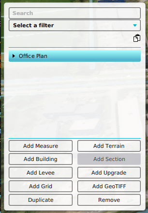

A measure can contain spatial components. These include the placement of buildings, the manipulation of land and the execution of upgrades. To add a spatial component to a measure, select the measure you wish to add the effect to, and select one of the following options:
  • "Add Building" to add the placement of a Building.
  • "Add Section" to add a section to the selected Building.
  • "Add Terrain" to add a manipulation of height and type of terrain. Has the following subtypes: water, raise and flatten.
  • "Add Levee" to add the placement of a levee
  • "Add Upgrade" to add the option to apply a type of upgrade to existing buildings.
  • "Add Grid" to apply a grid to the DTM, for a manually selected or automatically calculated MultiPolygon.
  • "Add GeoTIFF" to apply a GeoTIFF to the DTM, for a manually selected or automatically calculated MultiPolygon.
Of each type, multiple effects can be added, e.g. a measure can place multiple buildings, and/or perform multiple upgrades.
To remove a spatial component from a measure, select the spatial sub-item you wish to remove, and select "Remove". Make sure to select the sub-item, and not the measure itself.

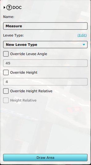

Levee spatials can also be added to a measure. A levee is required for this spatial to be applied. Specific parameters, such as the angle and height can be overwritten.

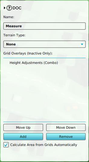

Both Grids and GeoTIFFs can be used by measures to adjust the DTM. The area of effect can be calculated automatically; since NO_DATA values are ignored. Alternatively, a manual selection can be provided. Multiple Grids and GeoTIFFs can be applied together. Additionally a Terrain Type can be supplied, which can be useful when applying detailed waterways.
Grids are required to be calculated beforehand and set to inactive.
