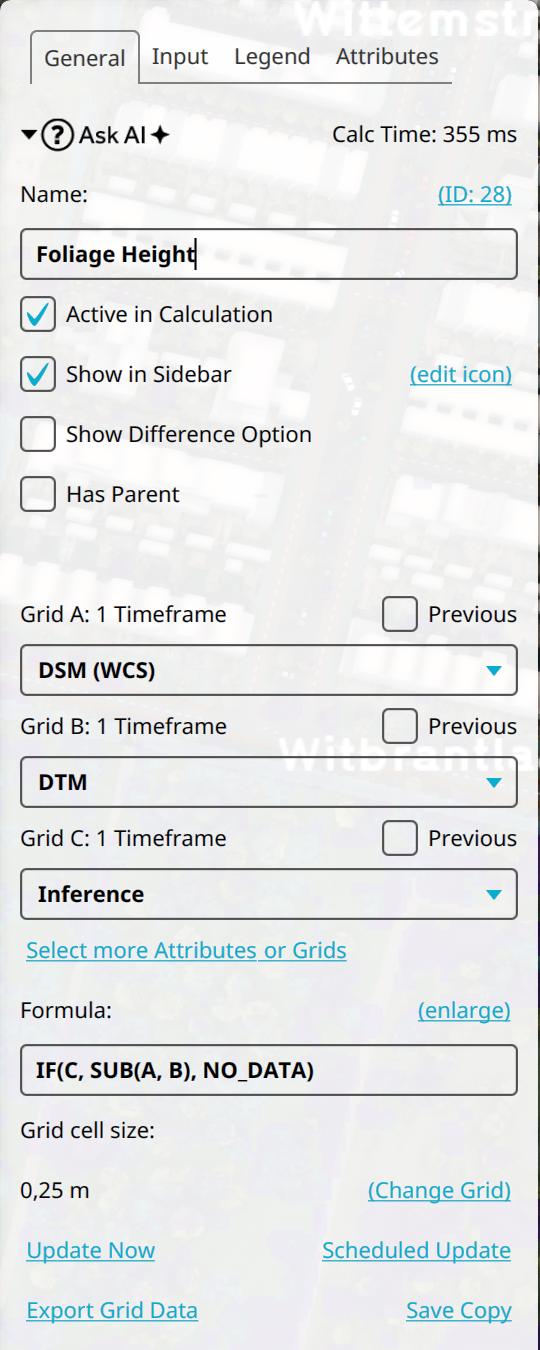

- Add a Combo Overlay, named Foliage Height with the following prequels:
- A: Heightmap (DSM)
- B: Heightmap (DTM)
- C: Inference Foliage
- Select the general tab in the detail panel, and provide the following formula using the formula field: IF(C, SUB(A, B), NO_DATA)
- Hover over the calculation cloud again, and now click update.

The Combo Overlay's formula

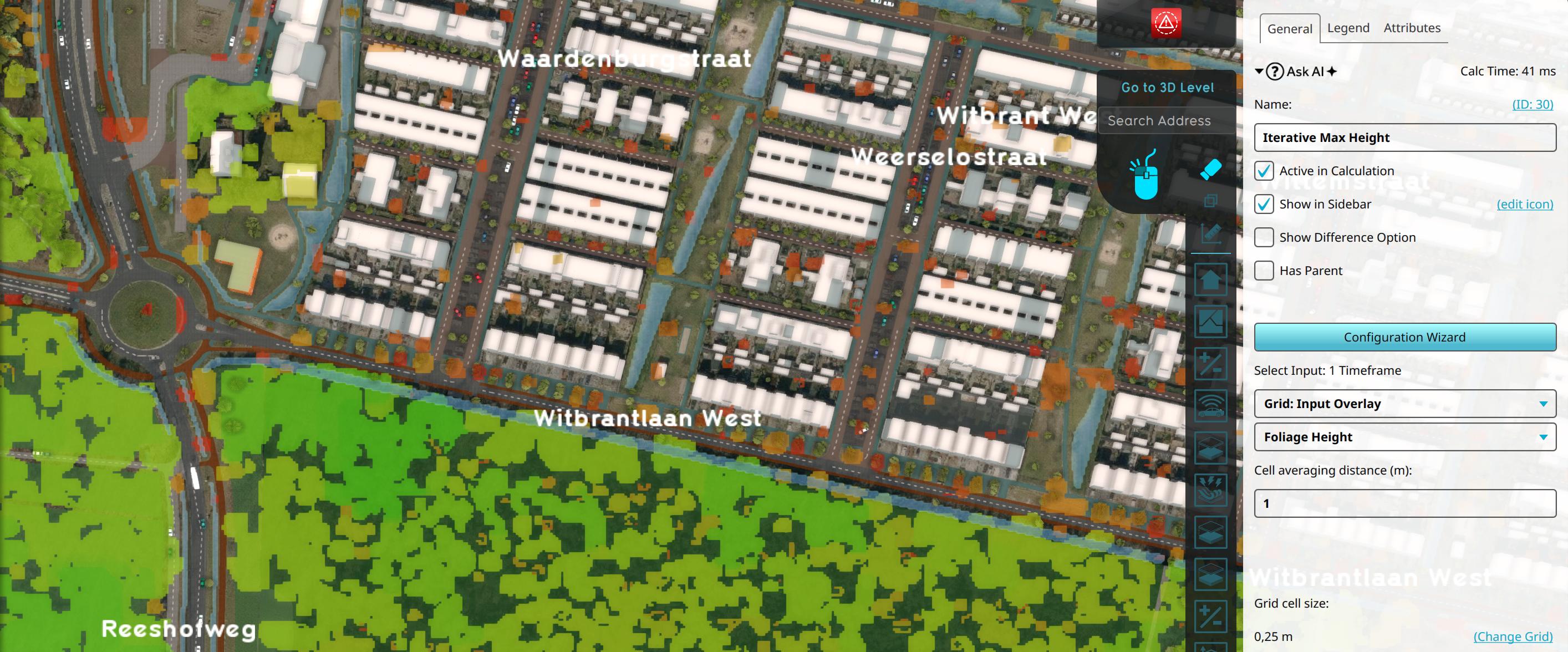

- Add an Average Overlay, named Iterative Max Height, with configured input Grid: Input Overlay and Result Type set to Max. Select the Foliage Height overlay for the Overlay and set the cell averaging distance to 2 times the grid cell size

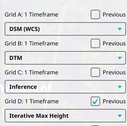

- Select the Foliage Height Combo Overlay again, and select the Input Tab in its detail panel.
- For Grid D, check the Previous box, and select the Iterative Max Height overlay.

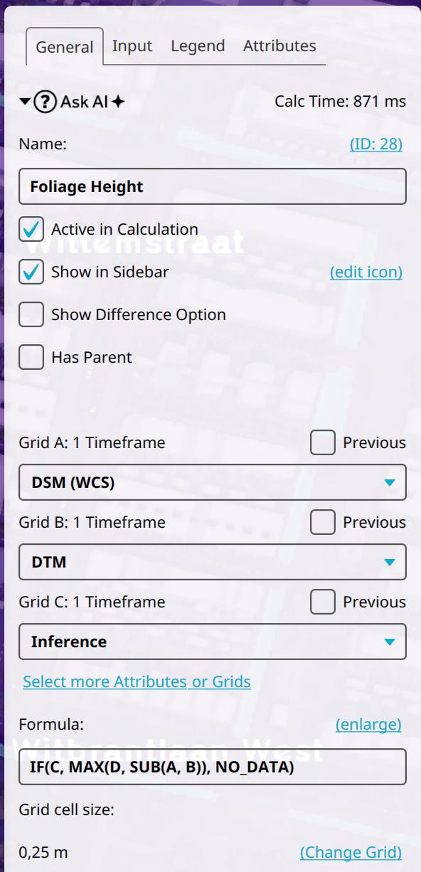

- Select the general tab in the detail panel, and provide the following formula using the formula field: IF(C, MAX(D, SUB(A, B)), NO_DATA)
The Combo Overlay's prequel. Notice the Previous option is selected for the Max Iterative Height overlay.
The Iterative Max Height overlay, which serves as an input for the Combo Overlay.
The Combo Overlay Formula
On the Foliage Height Combo Overlay formula:
IF(C, MAX(D, SUB(A, B)), NO_DATA)- If the Foliage Inference Overlay has a value, take the maximum of D (Iterative Max Overlay) and the relative height (DSM minus DTM).
- Otherwise, set it to NO_DATA.
