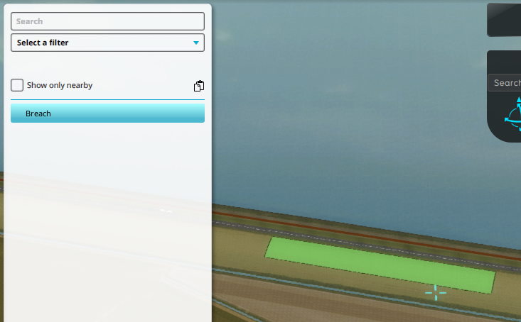

Breach Area
This how-to contain the steps that can be followed to an Area that is identified as a Breach Area for the Flooding Overlay.
How to "Add a Breach Area":

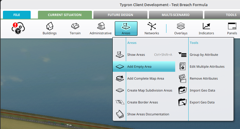

  1. Select Current Situation in the ribbon bar.
  2. Hover over Areas, and select Add Empty Area.
  3. Add a new Area.
  4. Rename it to Breach.
  5. Add new attribute BREACH_HEIGHT using the Add new attribute section in the attributes tab.
  6. Draw a selection for the breach.

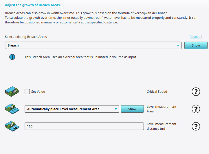

Disabling Breach Growth in Flooding Overlay
This how-to contain the steps that can be followed to disable the default Breach growth using the Flooding Overlay wizard. This is only required when the value has already been set.
How to "disable Breach Growth in Flooding Overlay":
  2. Click on Overlays
  3. Select the Flooding Overlay
  4. Click on the Configuration Wizard button in its detail panel.
  5. Continue to the Breach Growth Step.
  6. Select the Breach named Breach (added in the Breach Area section).
  7. Uncheck the option named "Set Value" for the setting named Critical Speed

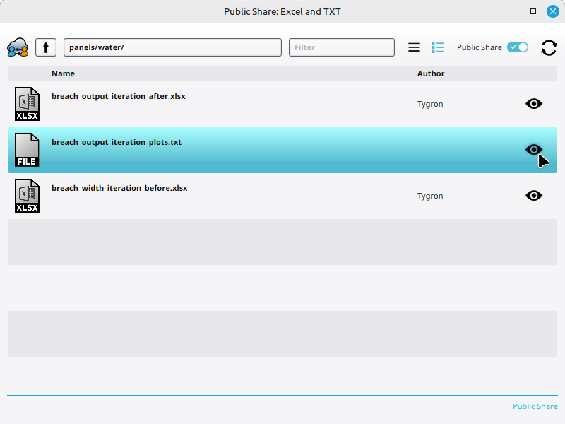

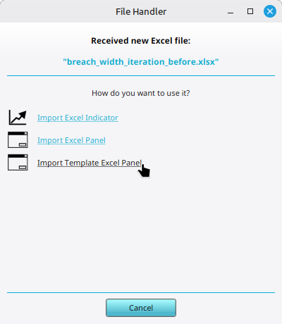

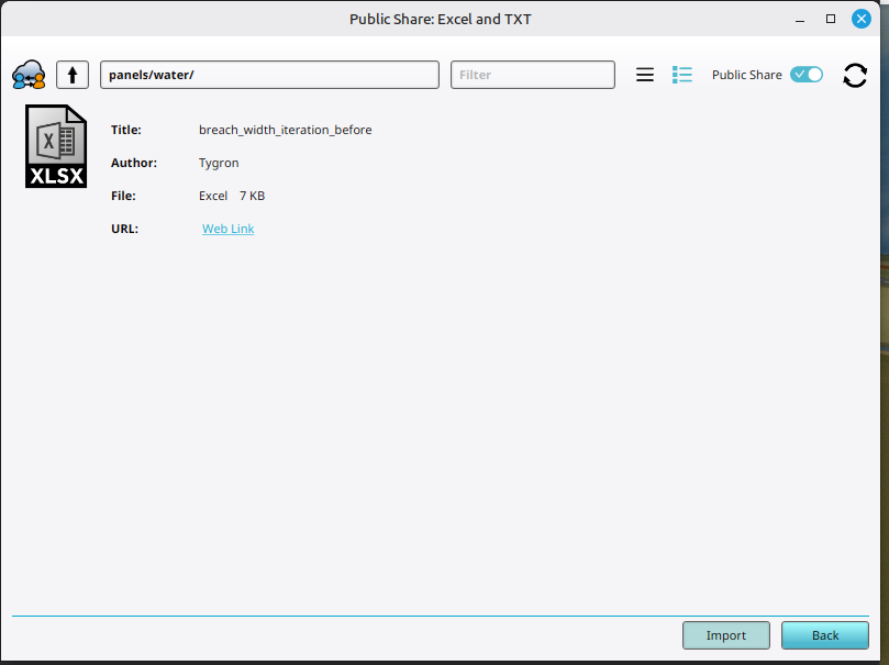

How to Import a Template Excel Panel for updating the Breach Width:

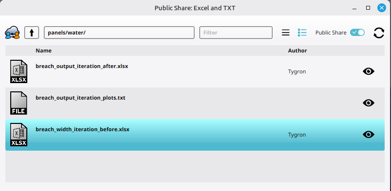

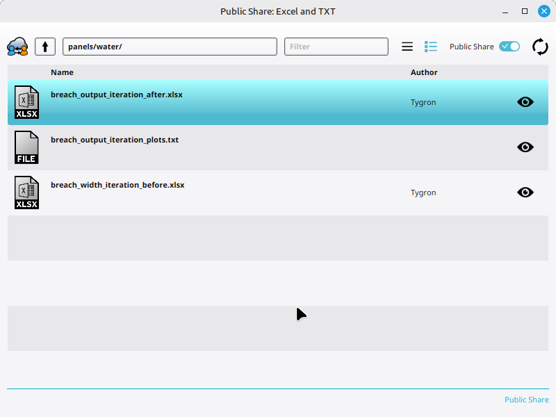

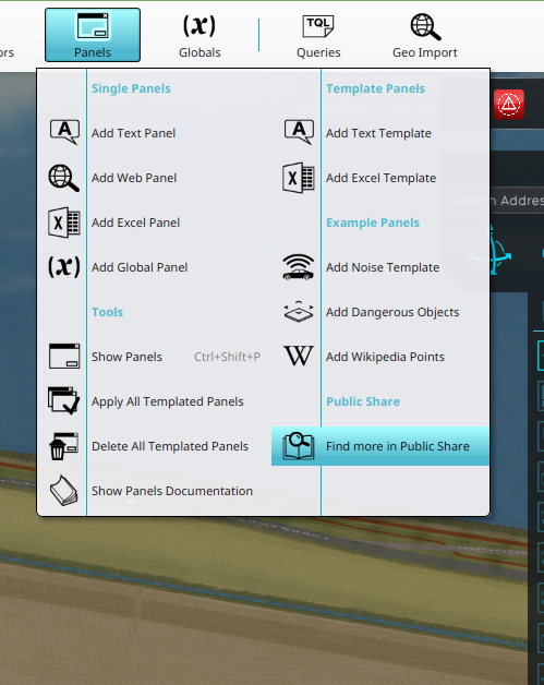

  2. Hover over Panels, and select Find more on Share.
  3. Navigate to Panels, Water and select the file named "Breach_width_iteration_before.xlsx"

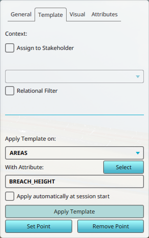

  4. With the Panel selected, select the Template Tab.
  5. Adjust the option below Apply Template on to Areas.
  6. Click on the Select button and select the attribute named BREACH_HEIGHT.
  7. Click on the Apply Template button to create a Panel instance for the Breach Area.

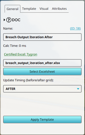

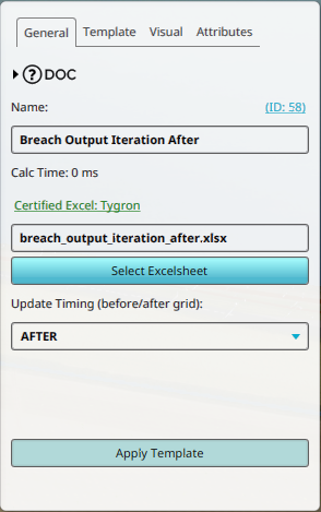

The following how-to contain the steps that can be followed to add a Template Excel Panel that stores the output values of a breach for each calculated iterations. This is necessary because each iteration, the default output values of the breach are overwritten. By adding this example excel file, you can see how to obtain the output values and append and store these under new attributes in the Breach Area.
How to Import a Template Excel for storing Breach output values:
  3. Navigate to Panels, Water and select the file named "Breach_output_iteration_after.xlsx"

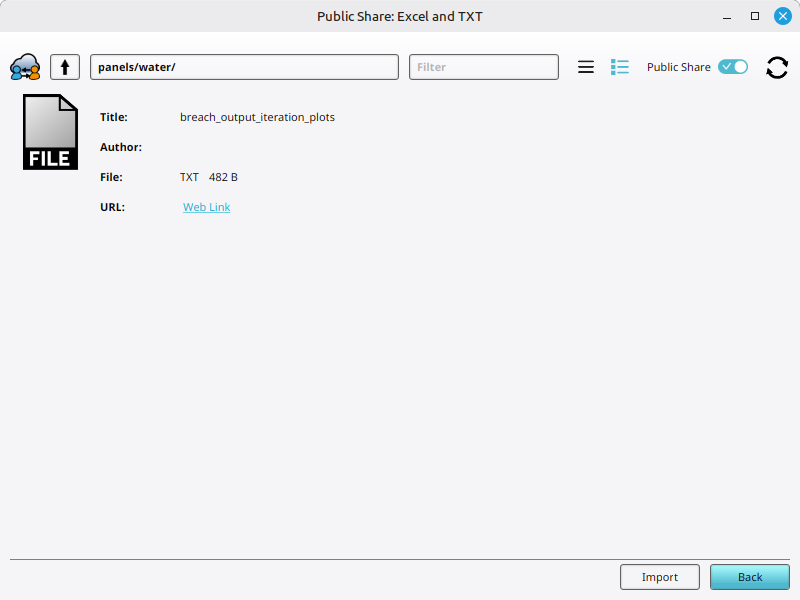

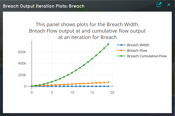

Breach output plot

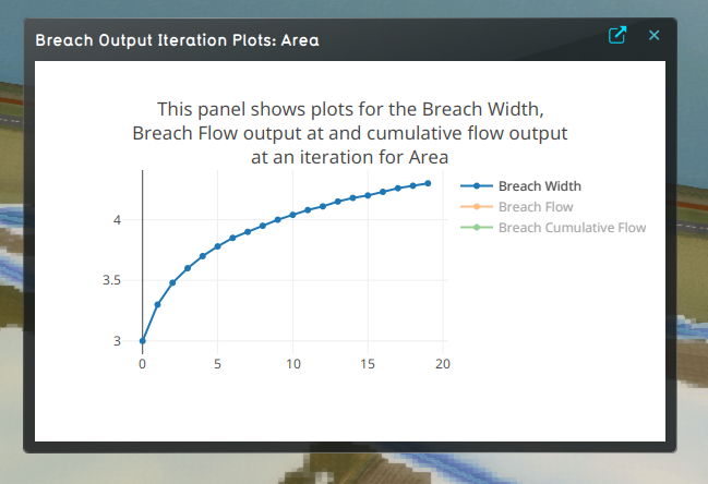

The following how-to contain the steps that can be followed to add a Template Text Panel that create a simple plot of the stored output values for a Breach. The Breach Width, Breach Flow and Breach Cumulative Flow are added to the plot.

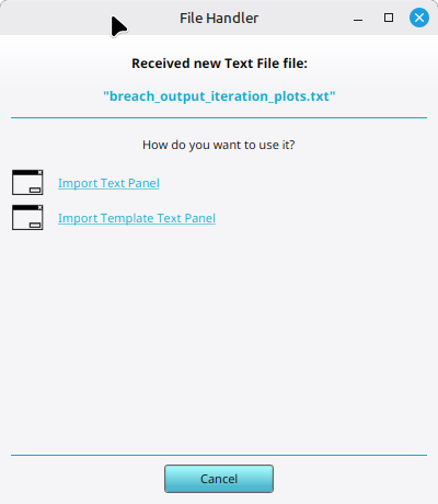

How to Import a Text Excel for plotting Breach output values:

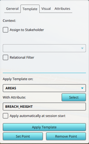

  2. Hover over Panels, and select "Find more on Share".
  3. Navigate to Panels, Water and select the file named "Breach_output_iteration_plots.txt"

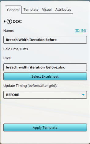

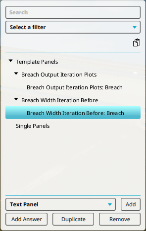

Breach Width Excel
The following how-to contain the steps that can be followed to edit the Breach Width Excel imported in one of the previous steps.
How to create a custom breach growth formula:

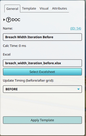

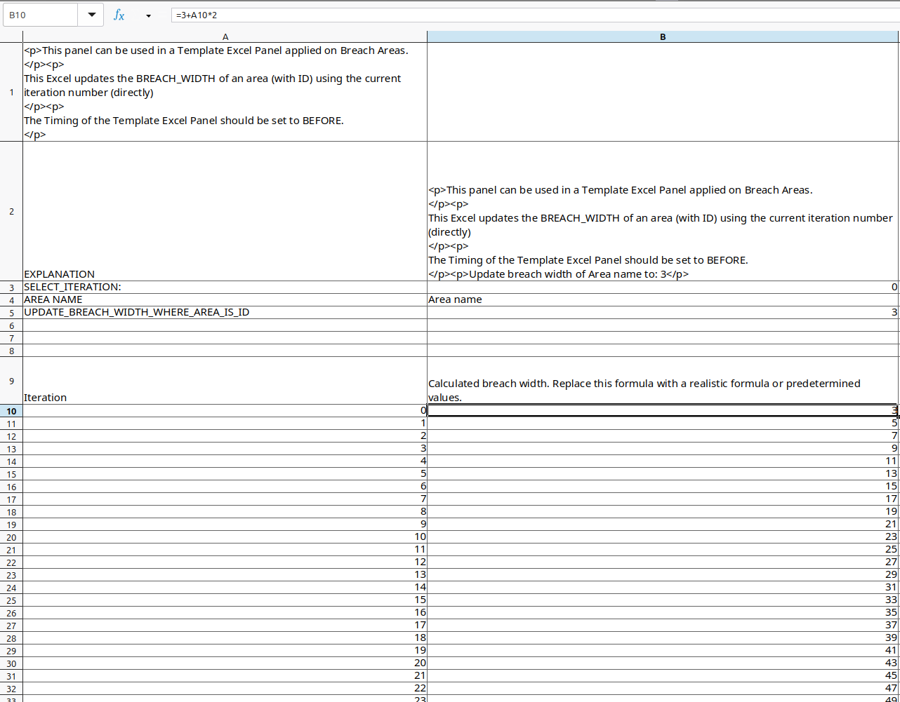

  1. Edit the Breach Width Excel
  2. Select the Template Excel Panel named Breach width iteration before
  3. Click on the Select Excelsheet button to open the Select Excelsheet Panel.
  4. Click on the Get icon of the accentuated excel named breach_width_iteration_before.xlsx to download it.

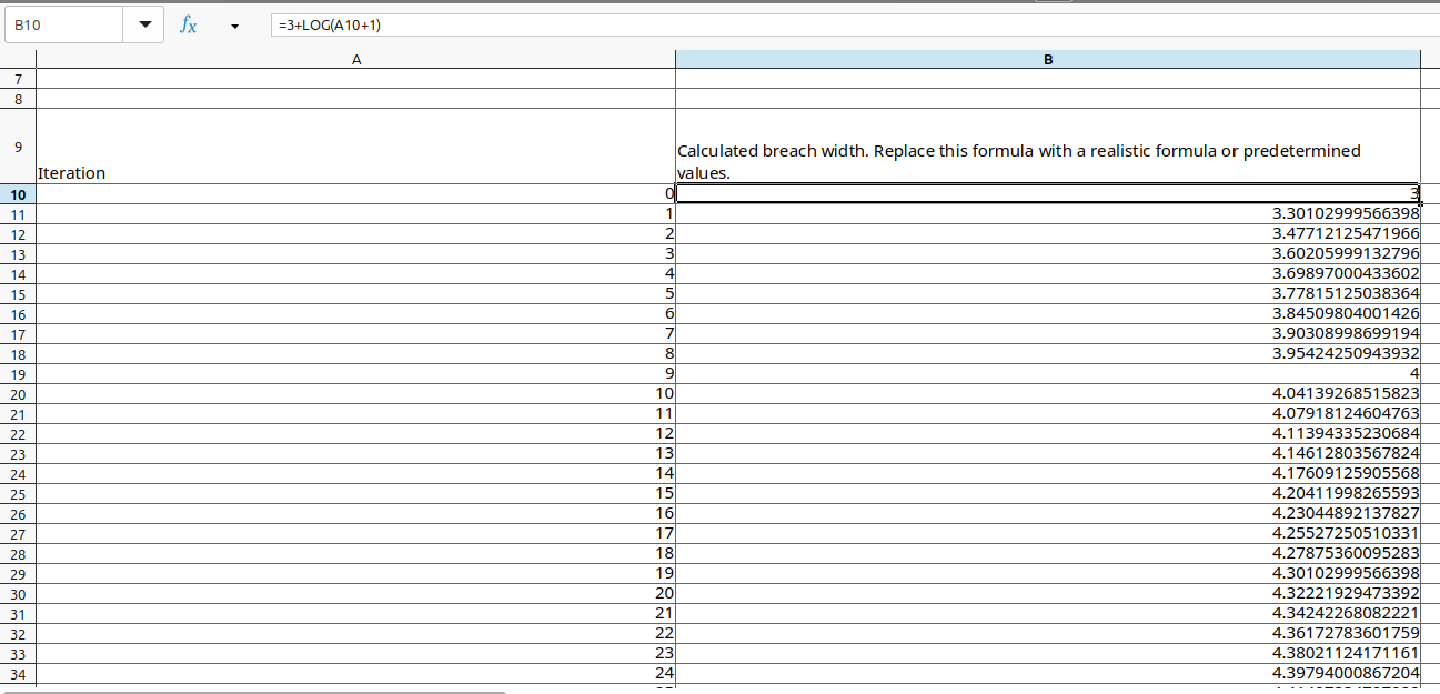

  5. Open the downloaded excel file using your installed Excel editor.
  6. Inspect the formula used in the B column below the text: Calculated breach width.
  7. Apply the formula to the cells below as well.
  8. Save the excel file
  9. Select the Template Excel Panel named Breach width iteration before

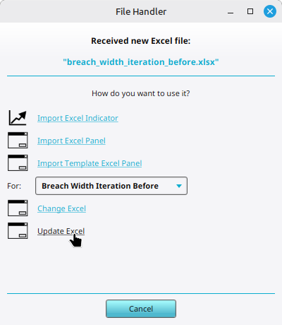

  10. Click on the Select Excelsheet button to open the Select Excelsheet Panel.
  11. Click on the Upload icon of the accentuated excel named breach_width_iteration_before.xlsx to upload a file.
  12. Select the saved and adjusted Excelsheet.
  13. Confirm with the select button.
  14. Click on the Apply Template button to reapply the template.
