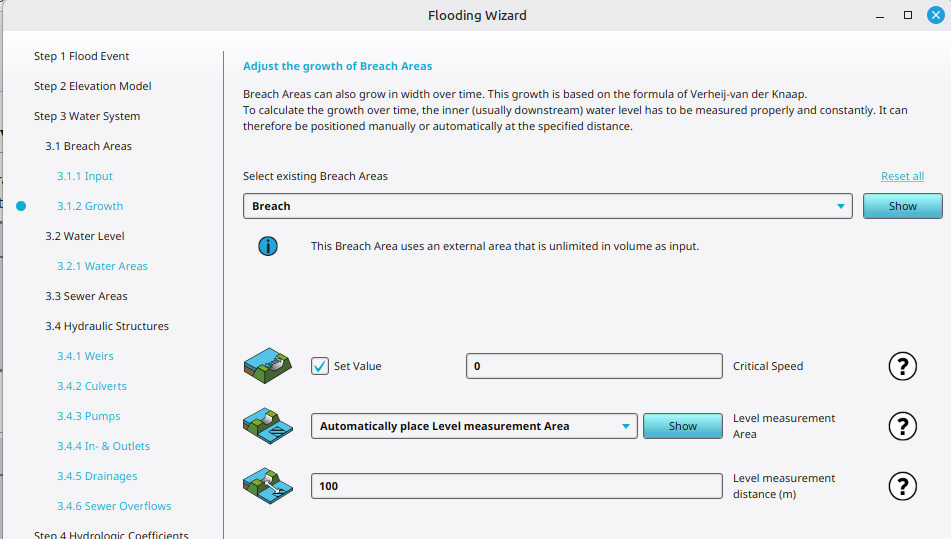

Disabling Breach Growth in Flooding Overlay
This how-to contain the steps that can be followed to disable the default Breach growth using the Flooding Overlay wizard.
How to "disable Breach Growth in Flooding Overlay":
  1. Select Current Situation in the ribbon bar.
  2. Click on Overlays
  3. Select the Flooding Overlay
  4. Click on the Configuration Wizard button in its detail panel.
  5. Continue to the Breach Growth Step.
  6. Select the Breach named Breach (added in the Breach Area section).
  7. Select the option named "Set Value" for the setting named Critical Speed
  8. Set the value in the value field of this option to 0.
