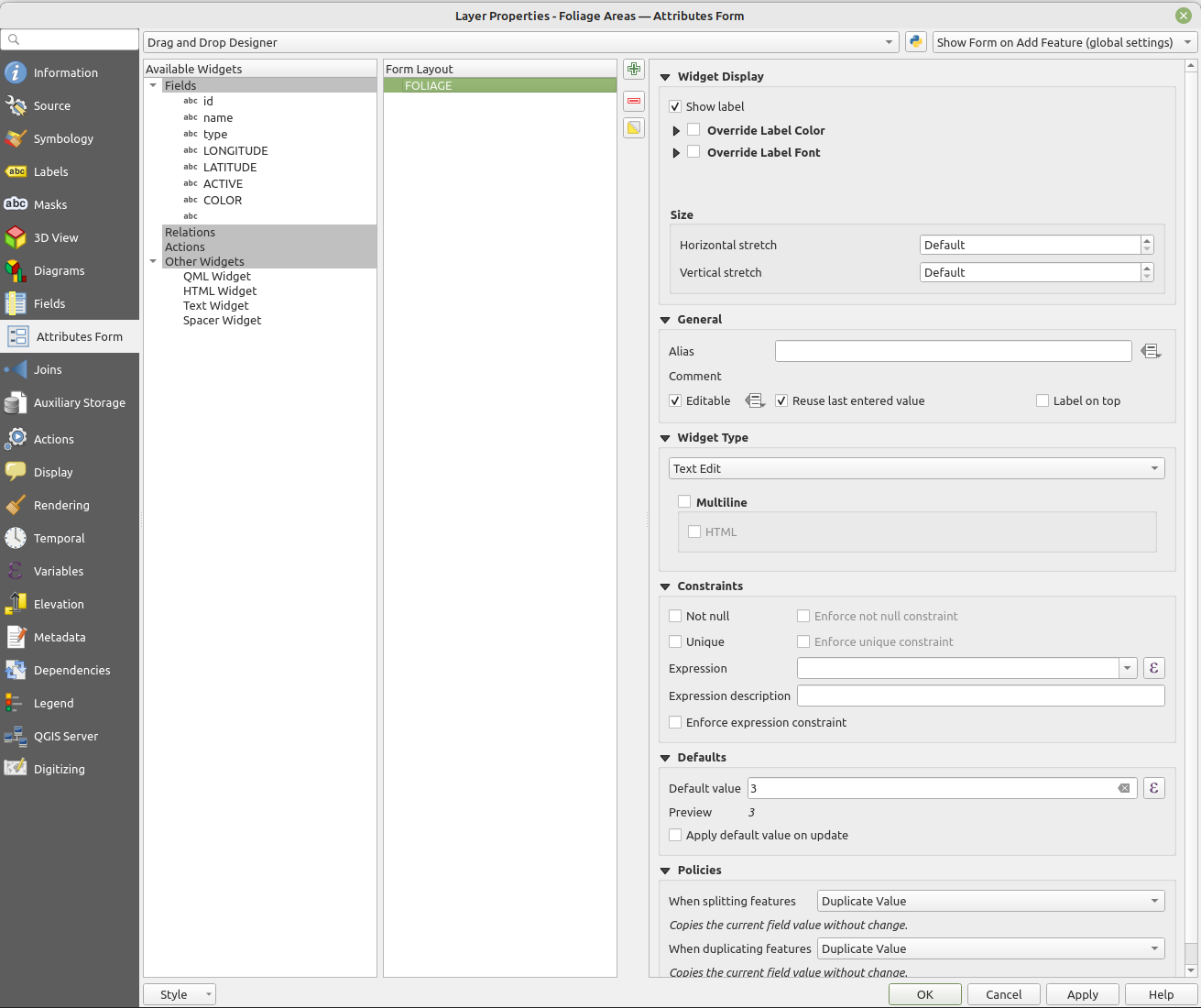

- Next select the tab Attributes Form
- Change the option to Drag and Drop Editor.
- Under form Layout, remove all fields except the FOLIAGE field.
- Select the FOLIAGE field, and under general, select the Reuse last entered value option.
- Optionally, under Defaults, set the Default Value to 1.
- Optionally, change the Text Field widget to Classification.
- Select apply to confirm.

Filled in attribute form.
Widget Type set to Classification.
