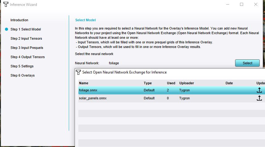

- In the Select Model step, click on the Select button to open the neural network selection panel.
- In the selection panel, select the Neural Network named foliage.onnx and click next to advance the wizard.

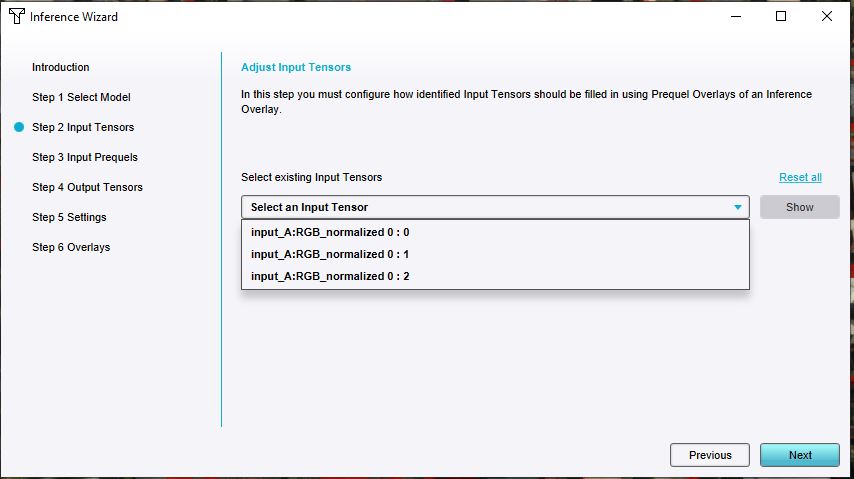

- In the Input Tensors step, verify that multiple input tensors are recognized and click next. These should be correctly configured.

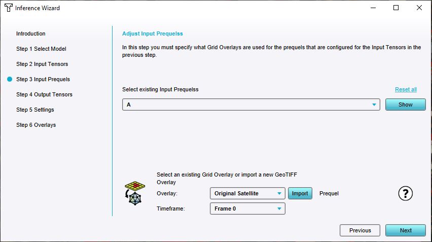

- In the Input prequels step, select the Input Prequel 'A', and under Overlay, select the Satellite Overlay. Click next.

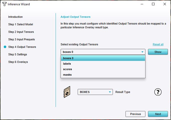

- In the Output Tensors step, verify that output tensors are present, click next.

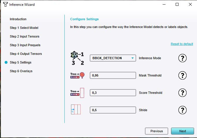

- In the Settings step, verify that the Score Threshold is around 0.3. This will lower the threshold to accept identified trees.
- In the Settings step, verify that the Mask Threshold is around 0.95. This will raise the threshold to include pixels of identified trees.
- Verify that the Inference Mode is set to BBOX_DETECTION and click next.

Select the 'Foliage neural network
Verify the existence of input tensors
Select 'Satellite Overlay' for prequel A
Verify the existence of output tensors
