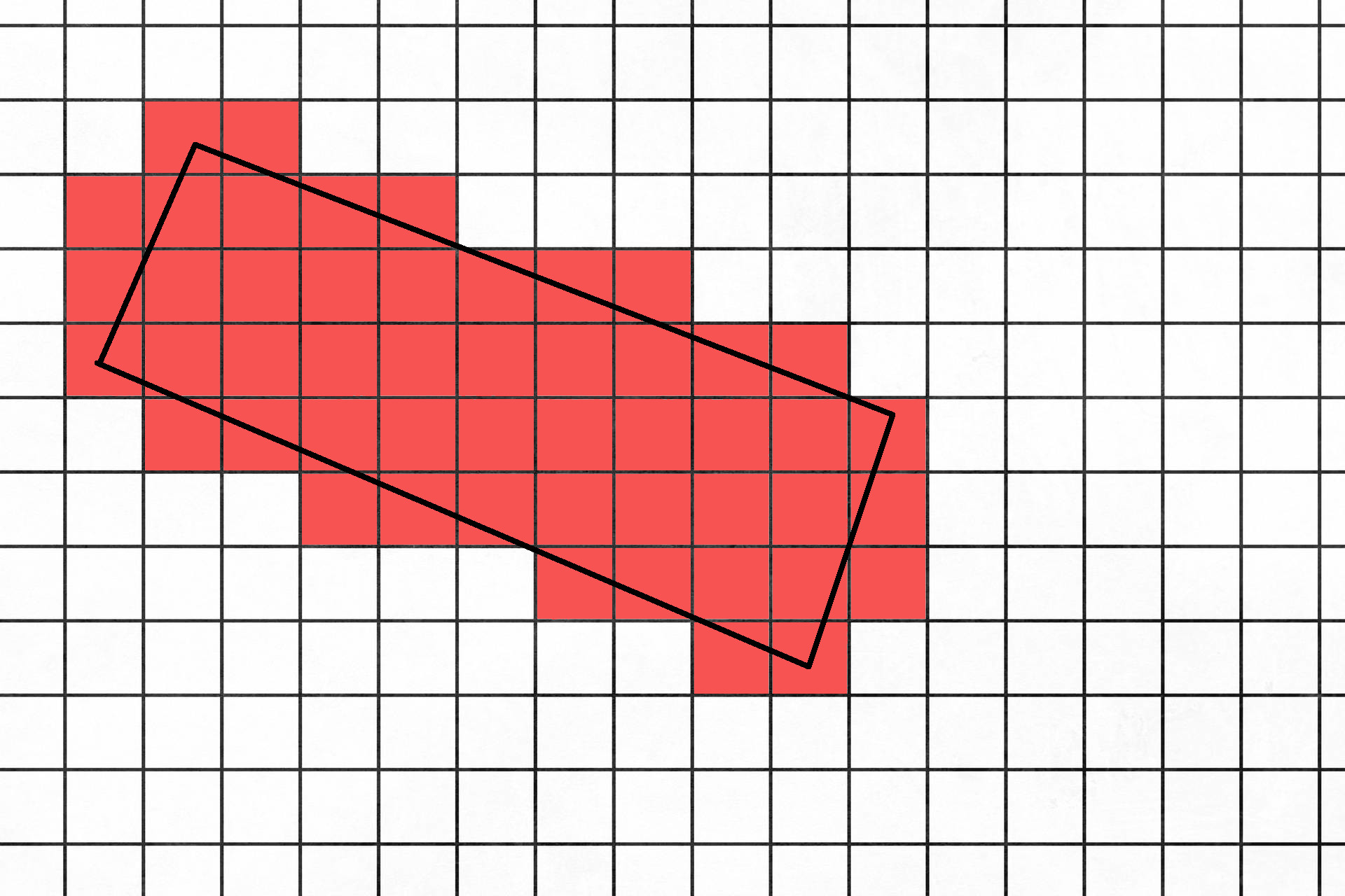

Converting polygons to grid cells can be done in different ways. A common approach is by checking the intersection between the polygon outline and the cell. As displayed below:
Outline rasterization method

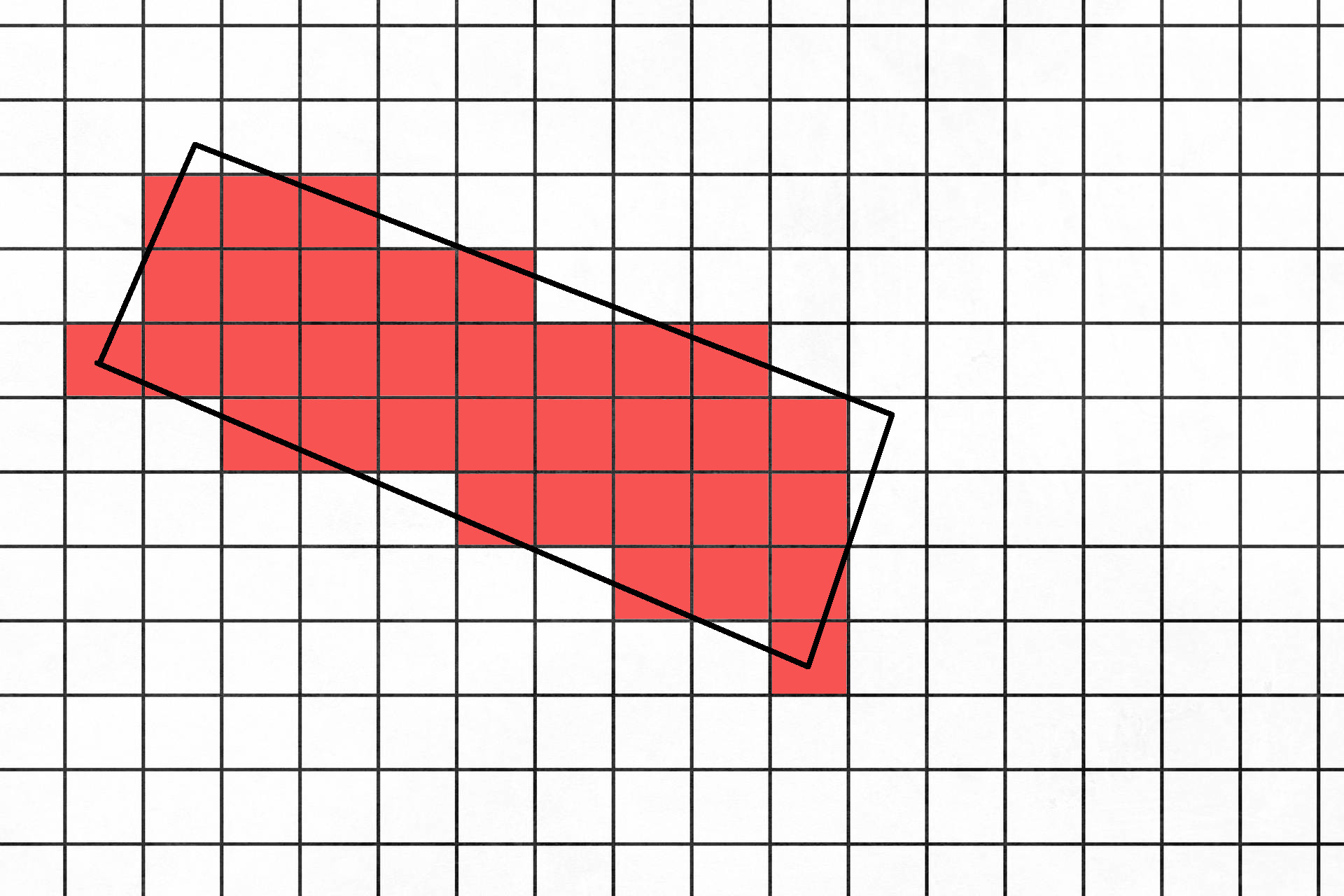

However this will create a small overshoot resulting in larger cell area than the original polygon. To correct for this one could also rasterize based on the center point. As displayed below:
Center rasterization method
While more accurate, this method may fail for objects smaller than the grid cell area. If the cell center point misses a small object, it won't be rasterized and remains as traversable space in the simulation.
