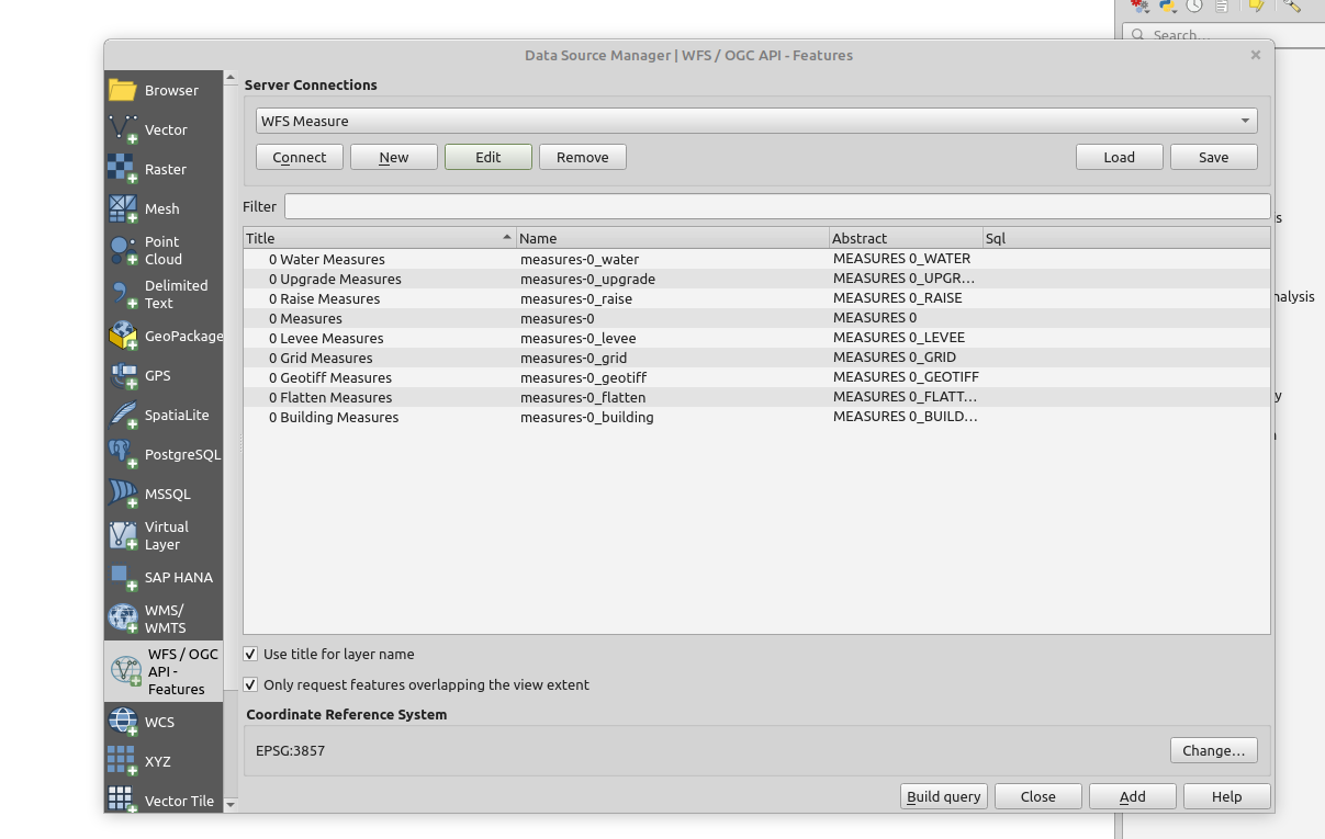

- Hover over Layers in the ribbon bar, and under Add Layer, select Add WFS / OGC Api Feature Layer
- In the Data Source Manager window, Click on the New button
- Provide a custom name for the service
- Select the URL field and paste the copied WFS URL.
- Click on OK.
- Click on Connect
- Select the Layers you want to edit and click on Add.
- Close the Window.
Obtain the URL by exporting a Measure as a WFS Service.
Select a layer from the project's Measure WFS connection in QGIS.

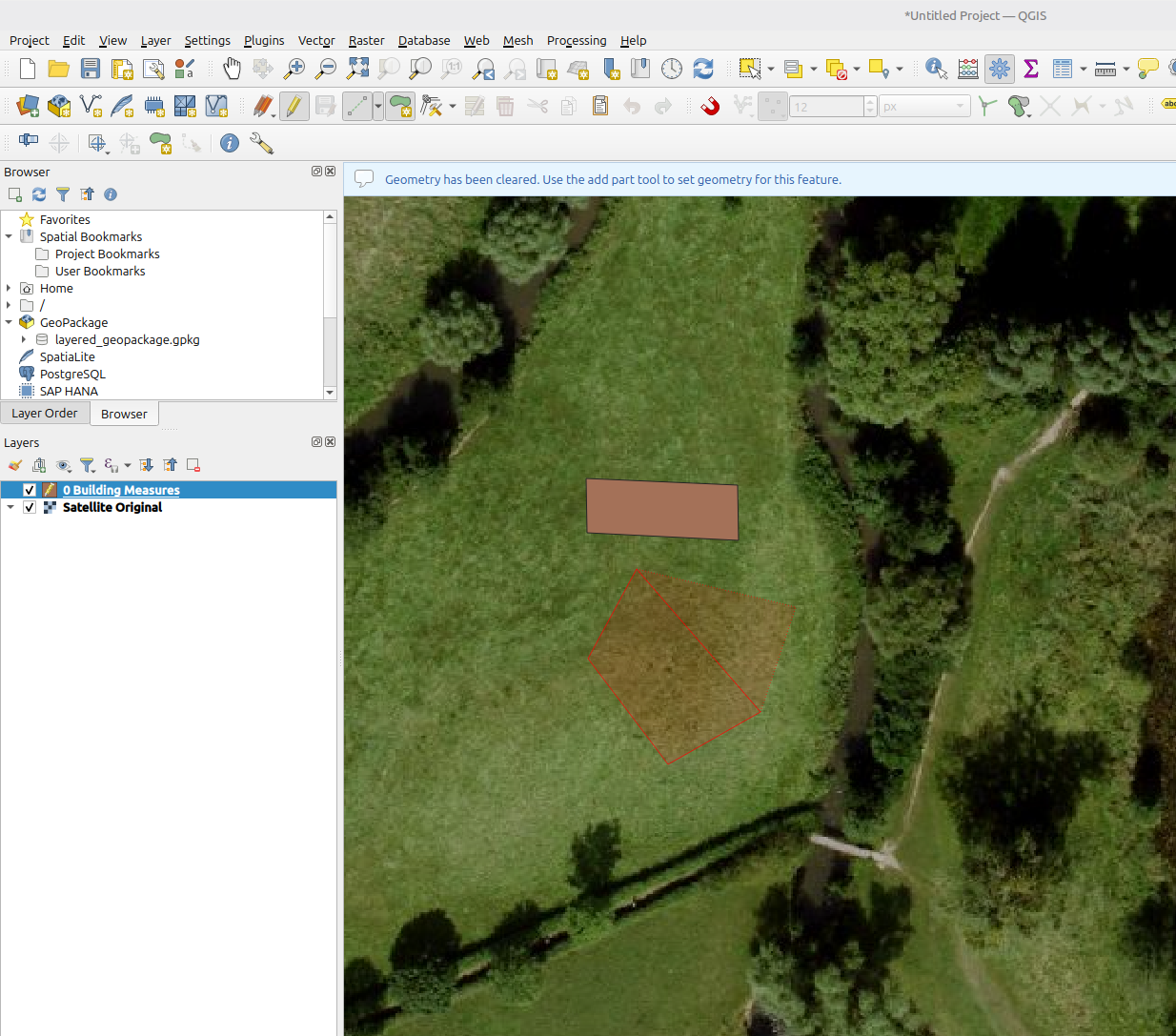

- To edit the layer, follow the steps described in How to edit your project data via WFS
Drawing a new Measure building next to an existing one, with Satellite Original WMS as background.

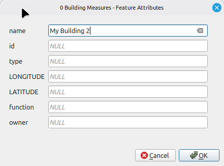

Providing a name for the added Measure Building.
Click on the save button to store the changes made to the layer.
