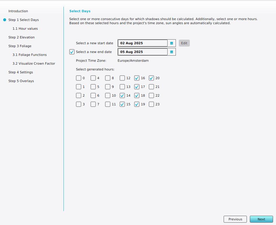

- In the Select Days step, click on the edit button and select a start and optional end date and select which hours of the day should be calculated.
- Click next to confirm.

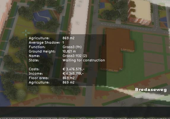

- Inspect the Overlay by clicking on the play button in the Overlay legend panel.
Select a start and end date.
Tooltip of calculated shadow overlay.
