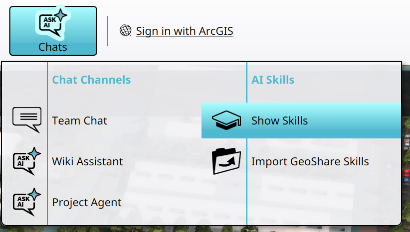

A Skill item is a structured configuration document that defines what an AI Agent is allowed to do, how it should behave, and which parameters control its generation. Think of it as the "job description" for an AI assistant: instead of shipping a one-size-fits-all chatbot, you add a Skill that scopes the agent's capabilities.
Show Skills in the Chats popup under Community.
