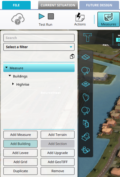

How to How to add a Building to a Measure:
  1. Open a project in the editor.
  2. Select Future Design in the ribbon bar.
  3. Click on Measures in the ribbon bar.
  4. Select the Measure you want to add a Building to.
  5. Click on 'Add Building' in the Measure Overview left panel

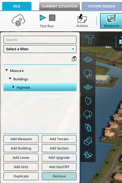

How to How to remove a Building from a Measure:
  4. Select the Building(s) of the Measure you want to remove.
  5. Click on 'Remove' in the Measure Overview left panel
  6. Confirm the removal in the dialog window.
