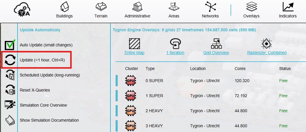

Heat risk (Indicator):
  1. Select in the editor Current Situation from the ribbon
  2. Hover over Overlays in the ribbon bar
  3. Select the Heat Stress Overlay from the drop down menu
  4. Hover over the Auto update icon and choose for Reset to Start values (faster) to update your project.
